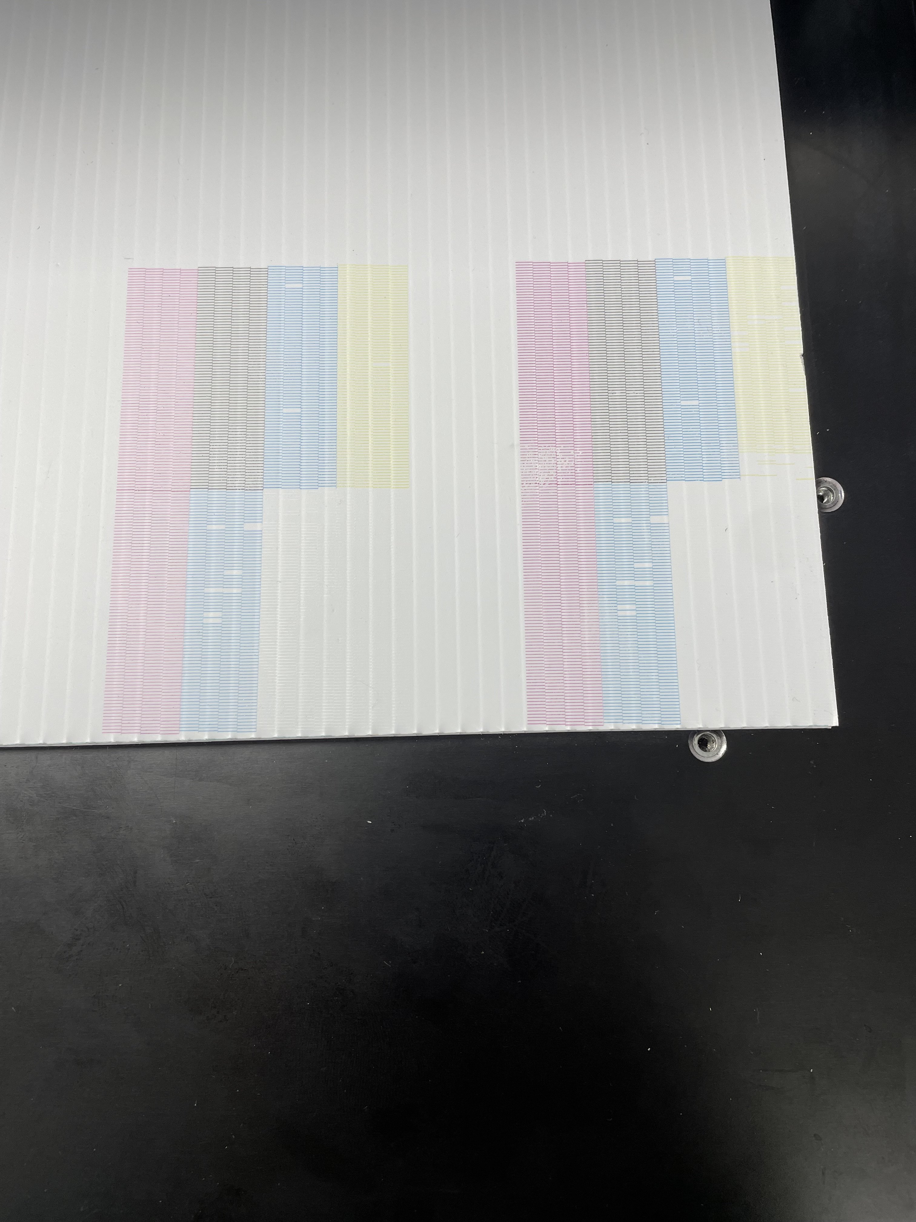

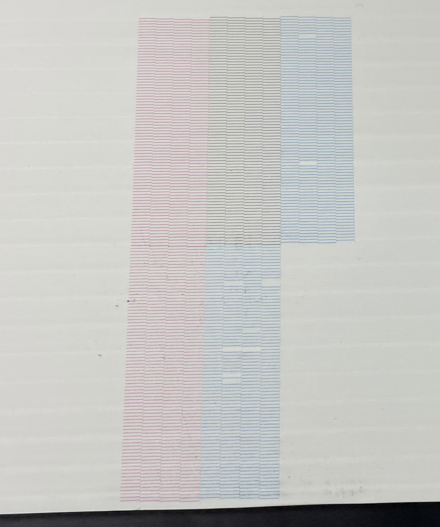

you are very lucky that Smoke Jaguar gave you some tips on what to do, I had the same problem, but no ink was coming when purged, yellow and cyan, on printed test, only half of the yellow and cyan was printing, did as much as I could and not luck, had to replace print head, (about ($6500 with this tech) about 7 months later, it happened again, but this time was different area and about half inch missing on the yellow and cyan, same tech was charging about 16K to do everything including flushing old ink, (we were using third party ink) and they said we had to use mimaki inks, we did not fix it, too much money, but found another tech that charged us about $5500 to do the same, more experienced tech, printing is great now, it has been already about 8 months.Thank you - Smoke so much. Last night I forgot to turn on main power of the printer. This morning I turn on the main power switch. the printer shows a error "SUPPLY INK:_ _ _Y _ _ _ _". I did subtank refill ink up and air purge, and test printing on which yellow nozzle check is prefect ( see attached picture). The situation happened for a number of times. Usually after a couple of days, yellow ink drops off again during printing. Do you think that this is the setting issue you mentioned or subtank sensor issue? thank you a lot
