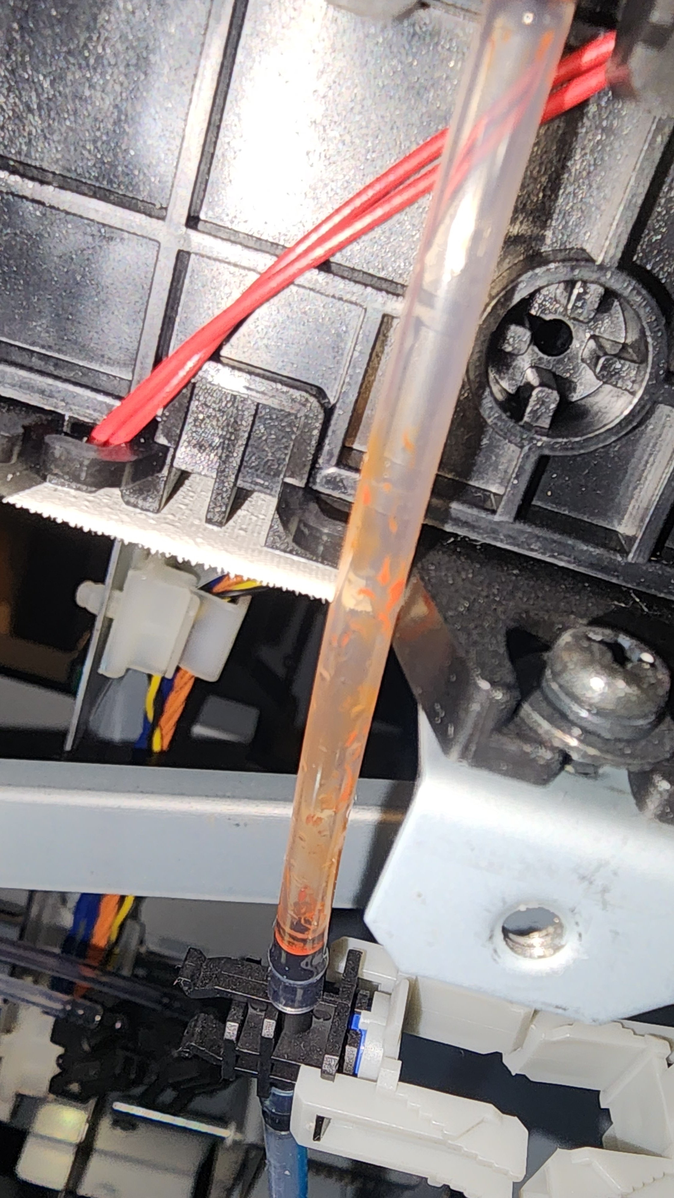

I still have residue like this in my orange and yellow line. Should I be worried? I can't to get these lines completely flushed.
Smoke_Jaguar
Pretty common to see residue in lines, the screens in the dampers keep it at bay typically. If you have gone a long time and lots of lines start getting kinda chunky, a full flush might not be a bad idea.
