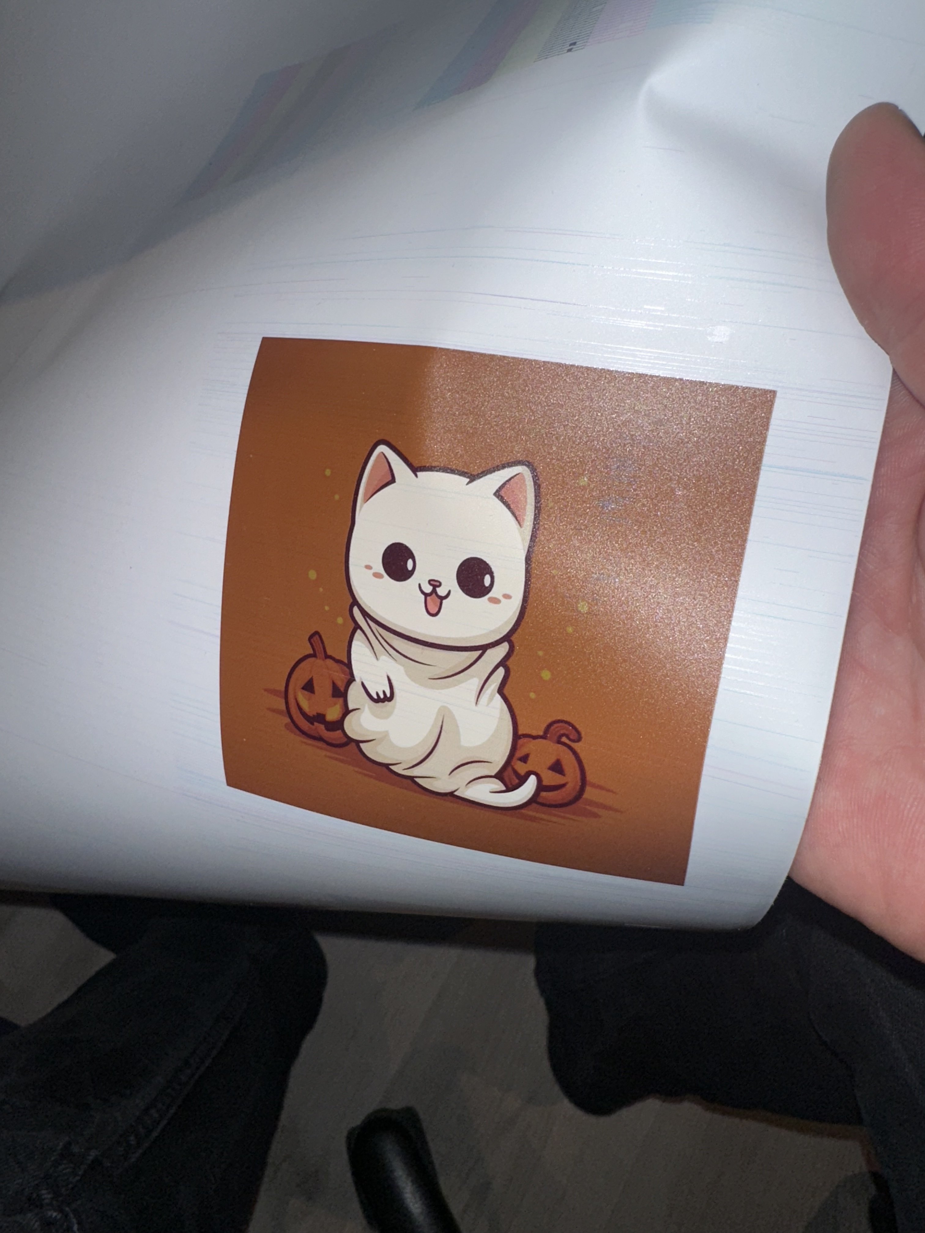

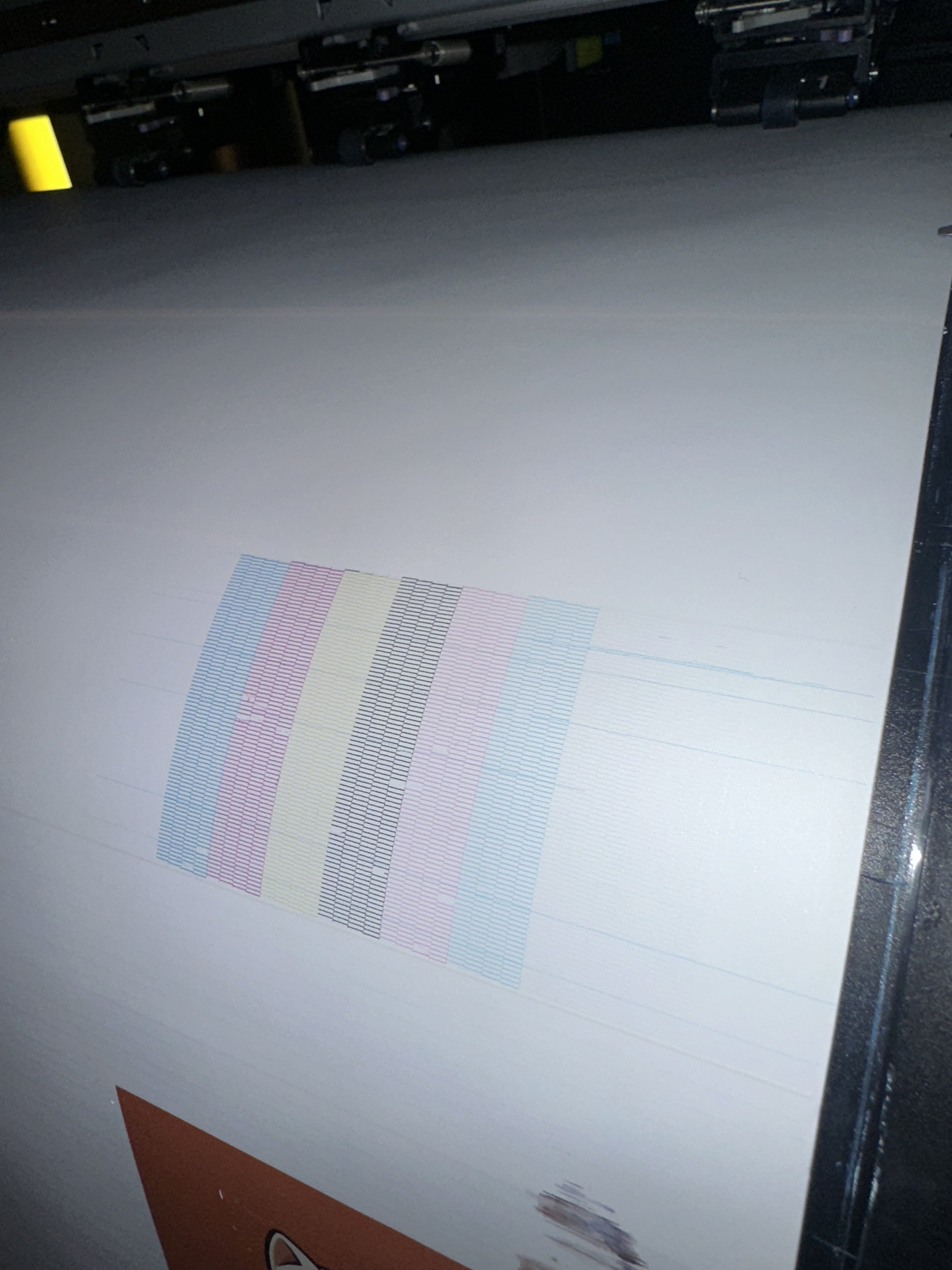

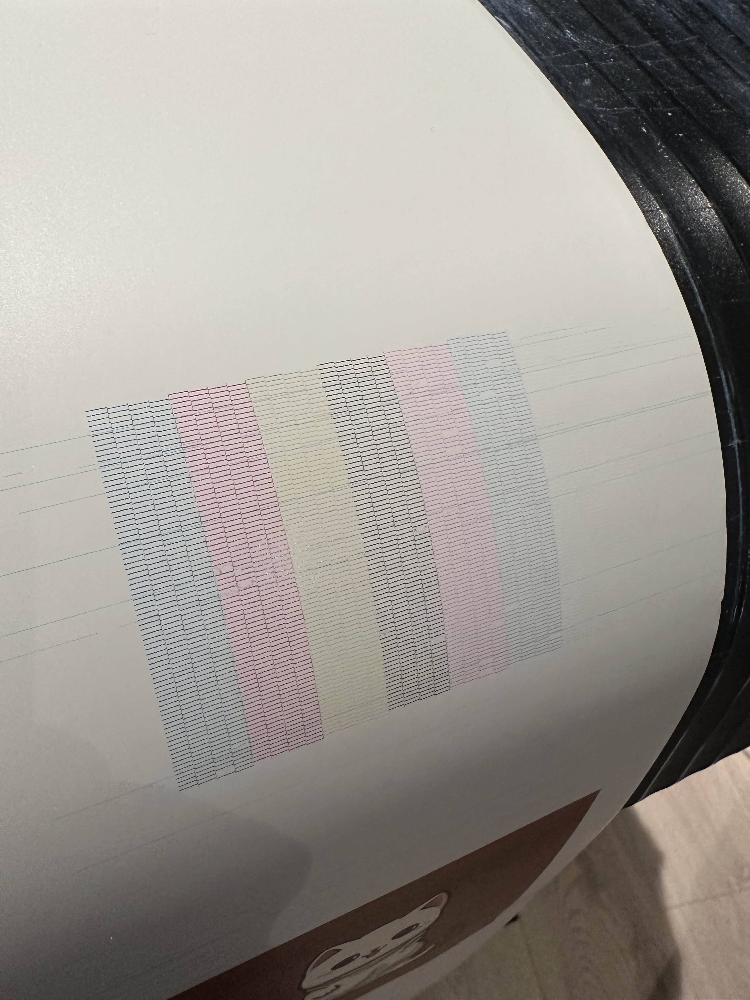

It’s now printing pretty good on all colours, but still have a problem with a few nozzles firing all the time. The error is on the second head (LcLmWW) I tried changing the multicolor ribbons from carriage board to print heads, but still the same head misfiring. Also changed the cable from main board to carriage board with the new shielded ones. From the nozzle recovery print I can find out which of the nozzles that are constant firing. Is there anyway in the service menu to disable these nozzles? Or any other solutions you can think of? I can’t spend money on a new head right now, so last solution would be to reprogram the printer to a "Ucjv 150" so it only uses one head.

I tried removing the ribbons to printhead 2 and changed the parameter 66 to 1 just to be able to do a test print, and the stripes disappeared. So it’s not a cleaning issues as I have been told from others
