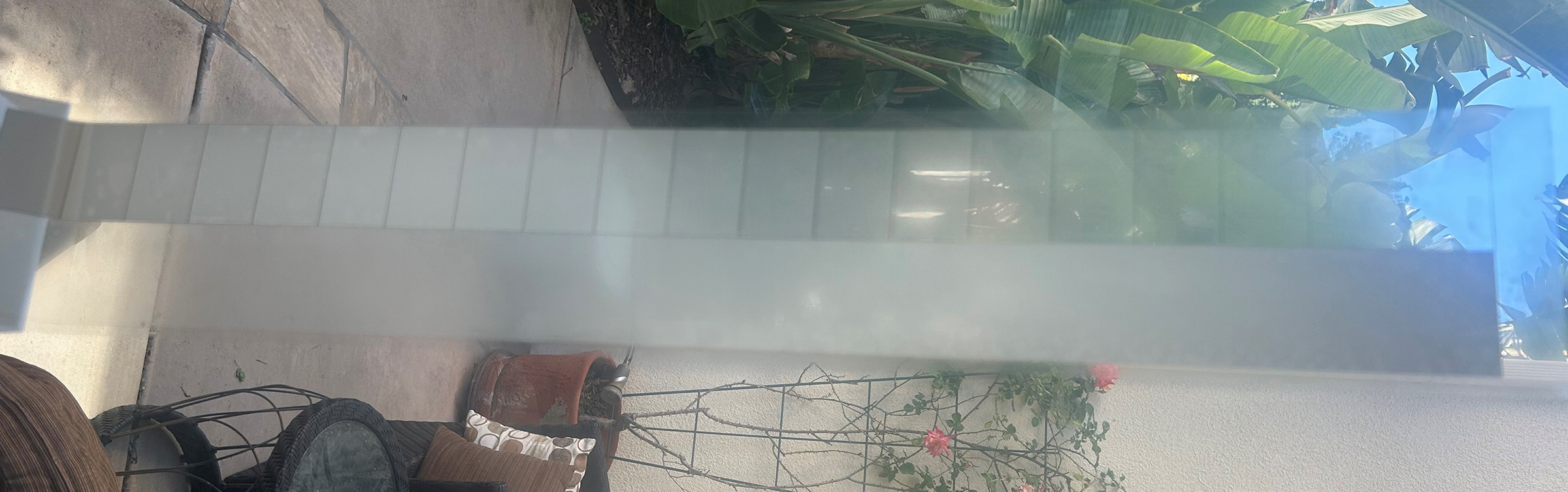

White ink can offer amazing utility for window films, including for privacy applications, among other use cases. Attached pic shows two graduations of white ink: the top is 5-percent steps from 100-0 white, and the bottom is a smooth graduation of white ink 0-100 percent.

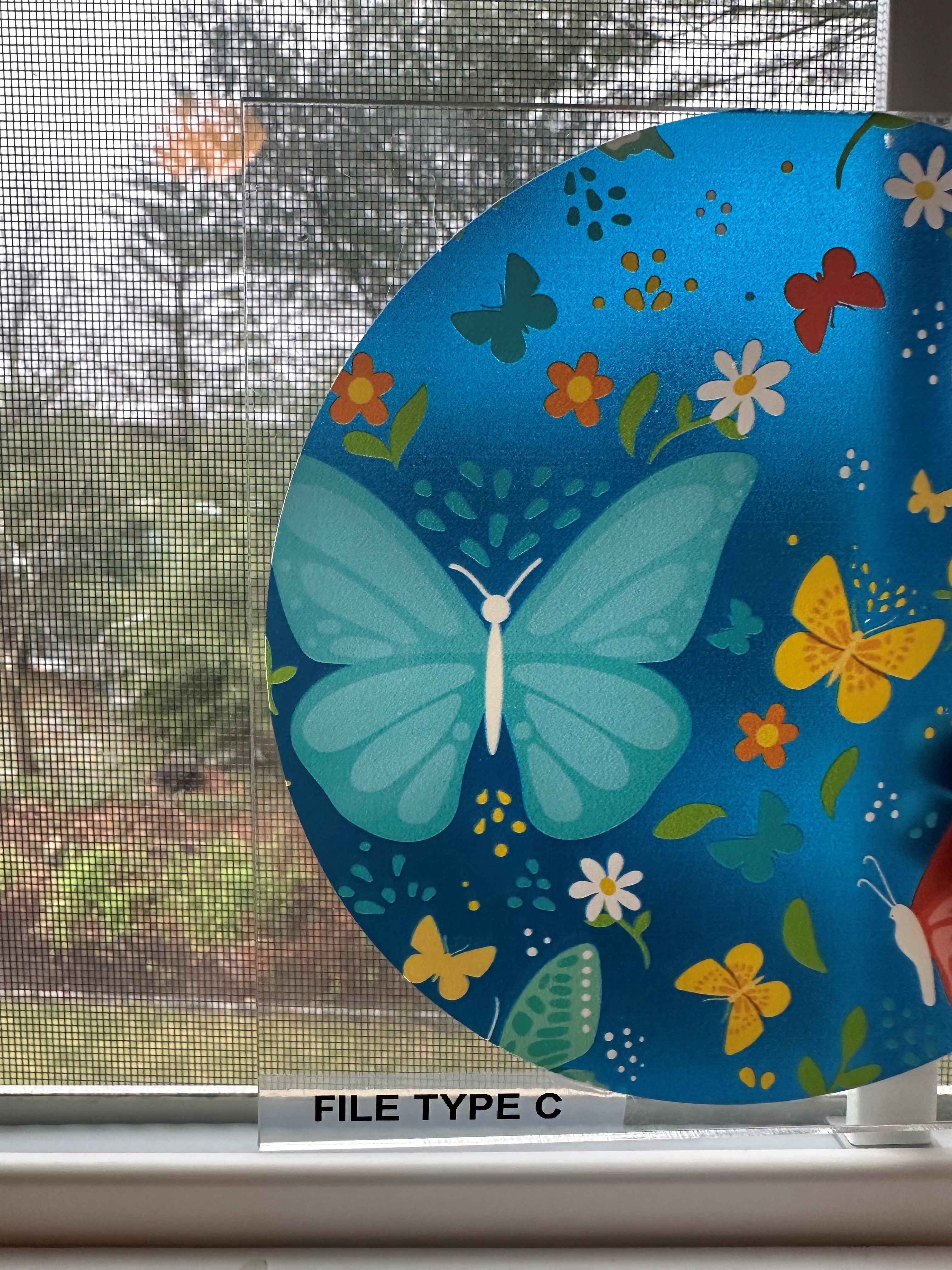

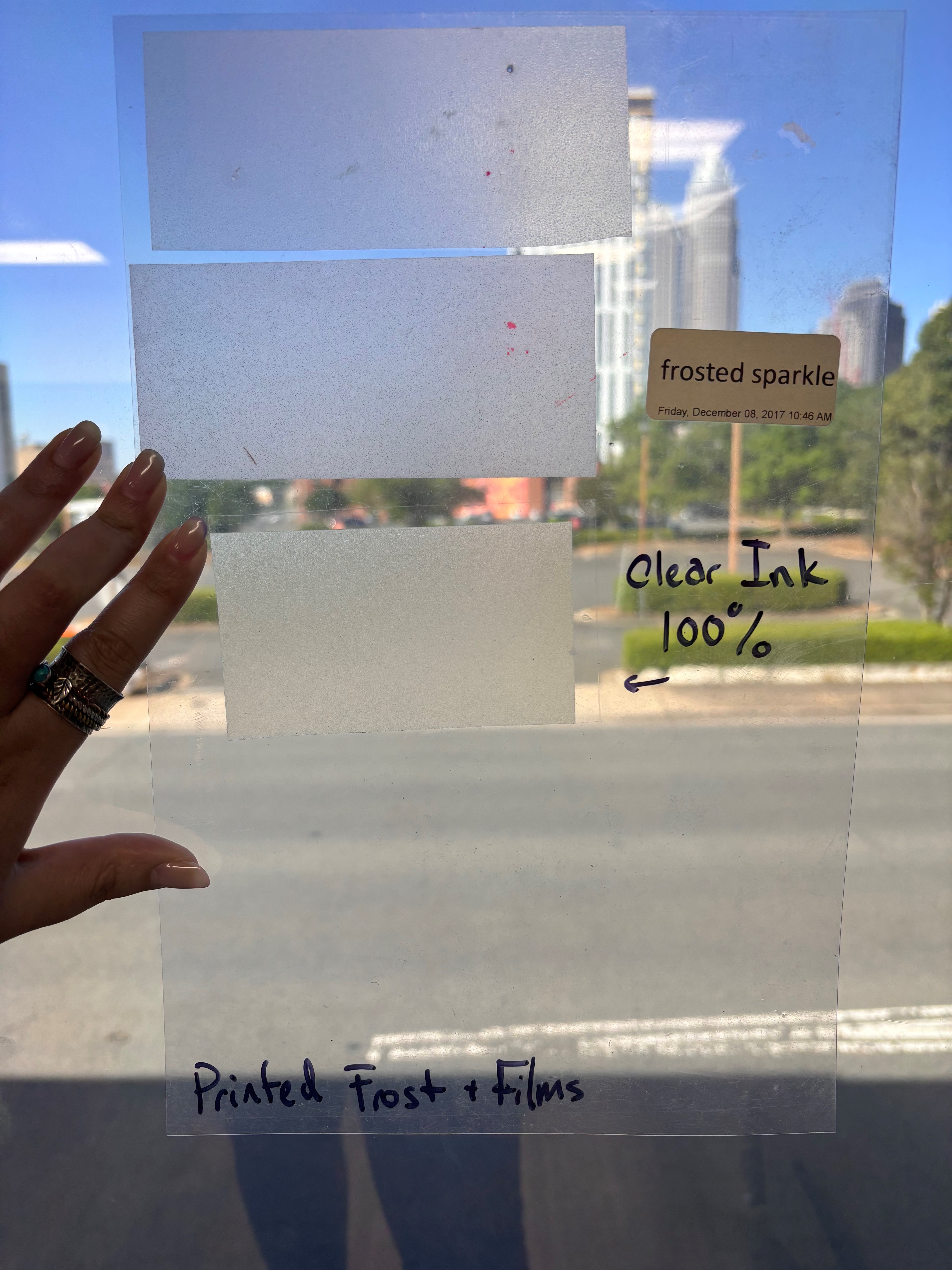

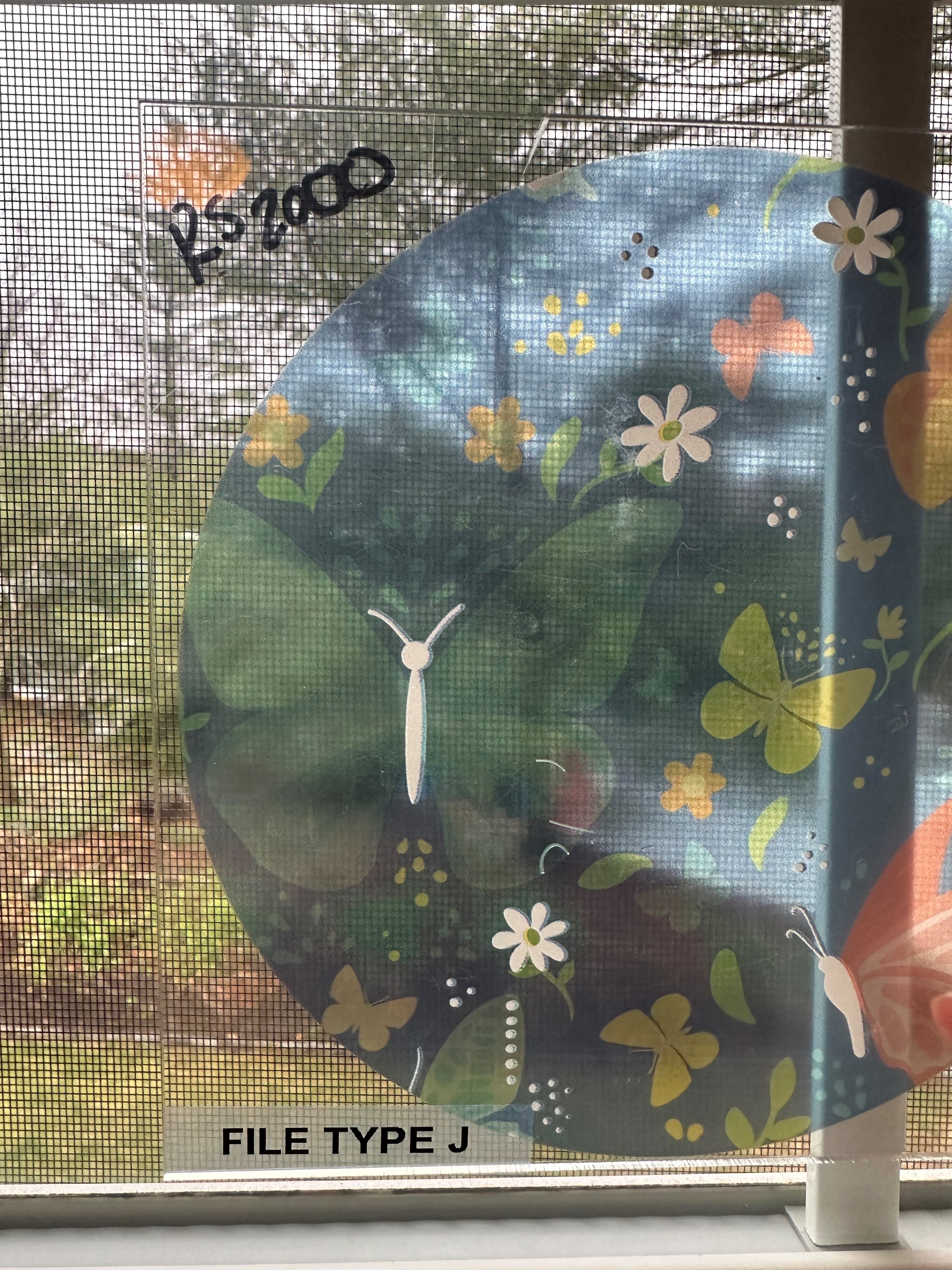

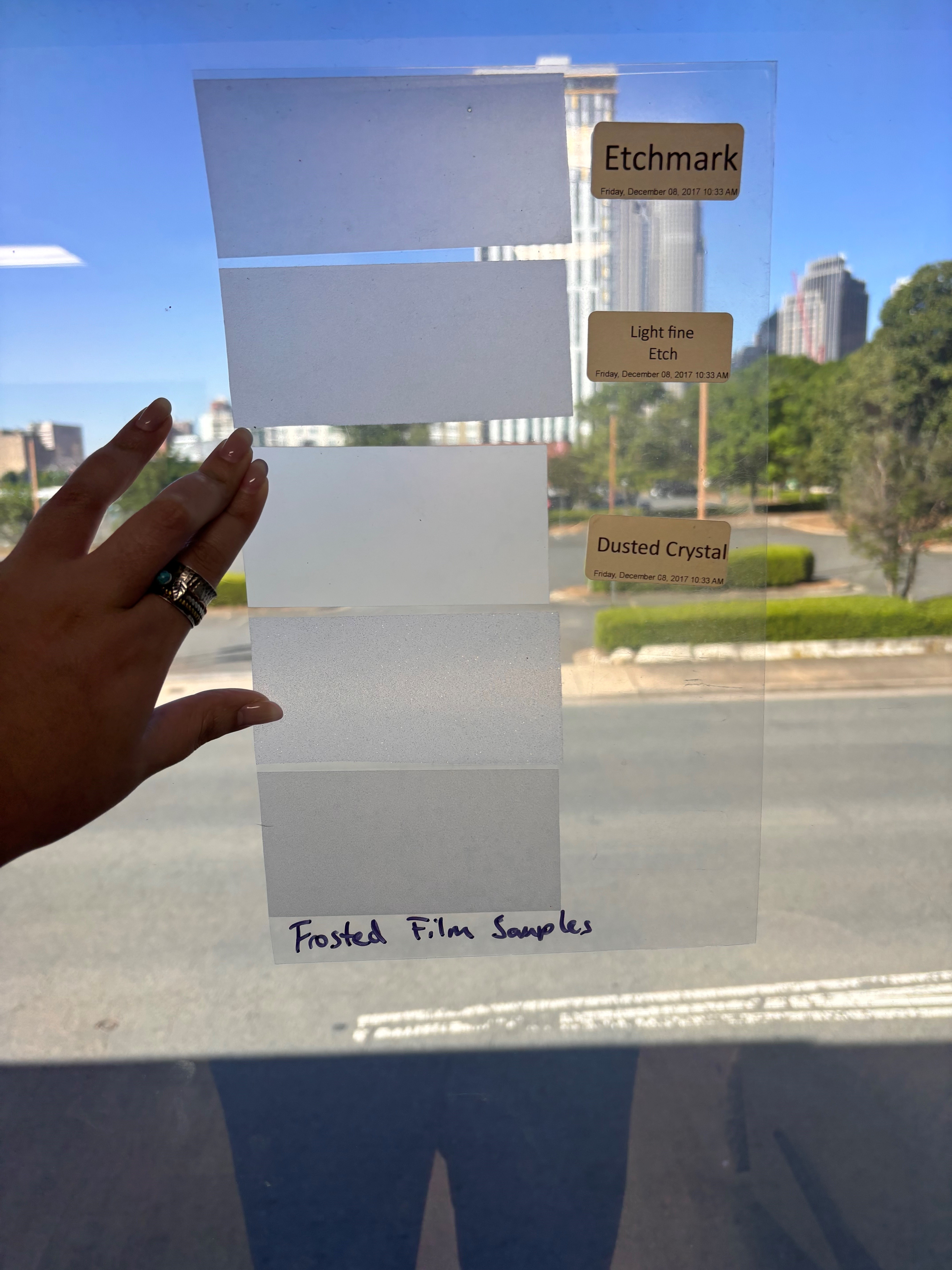

What kind of printer are you working with? As others mentioned white ink can give you something along the same line, though it's not really a frost. Clear gives more of a true frosted look. But any UV printer, even those without white or clear ink, can give you a kind of "frosted" look because the inks are thicker than a latex or inkjet. Attached a few photos to help illustrate this - look at the just the blue backgrounds in the butterfly images. type C is UV inks - the background is just blue, no white or clear ink used (there is white ink used behind the other graphics here, ignore that part) - linked comparisons of typical frost vs printed clear & printed white examples -examples

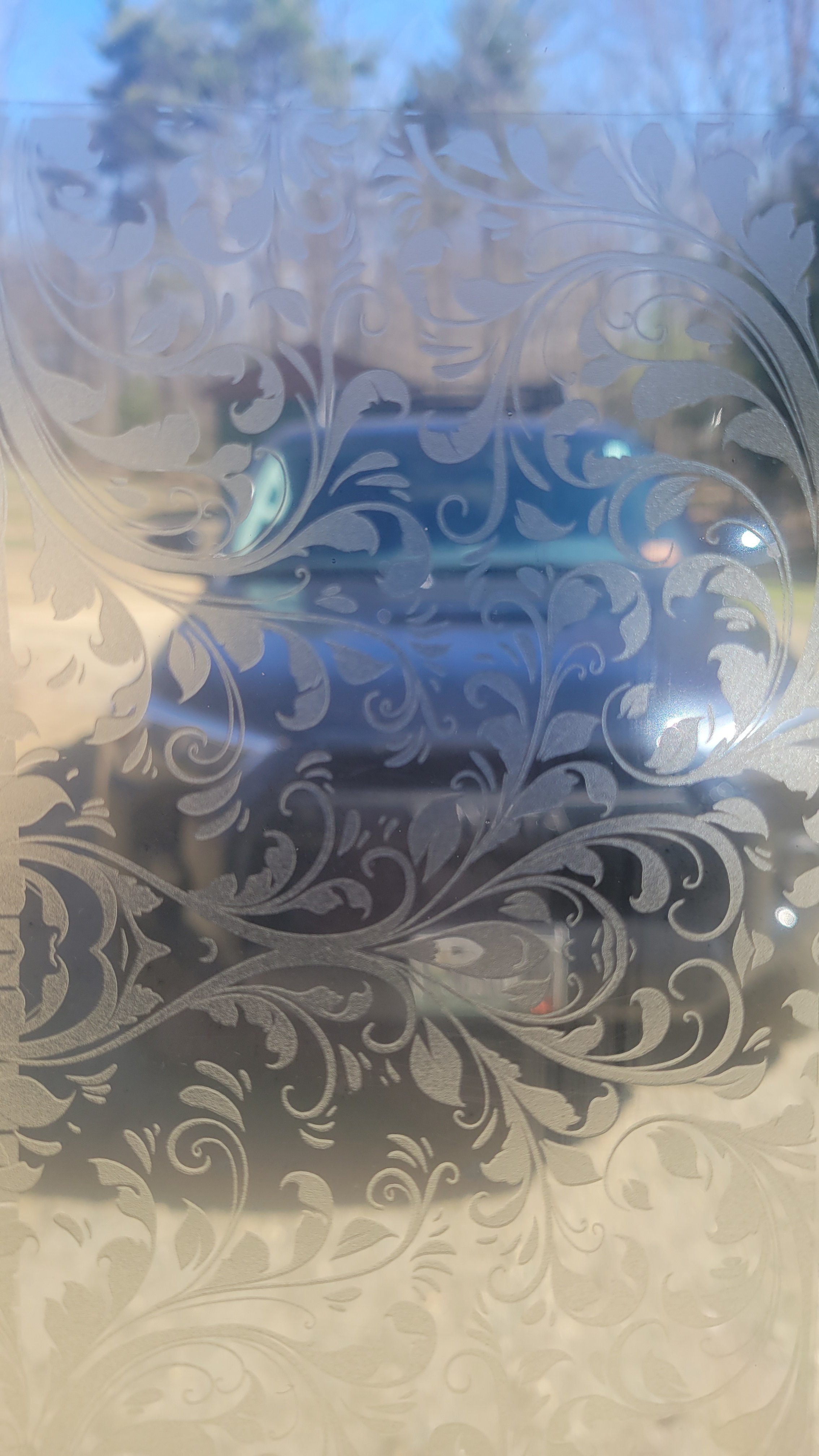

Yes, UV clear ink with matte finish printed with a UV machine can get you that effect.

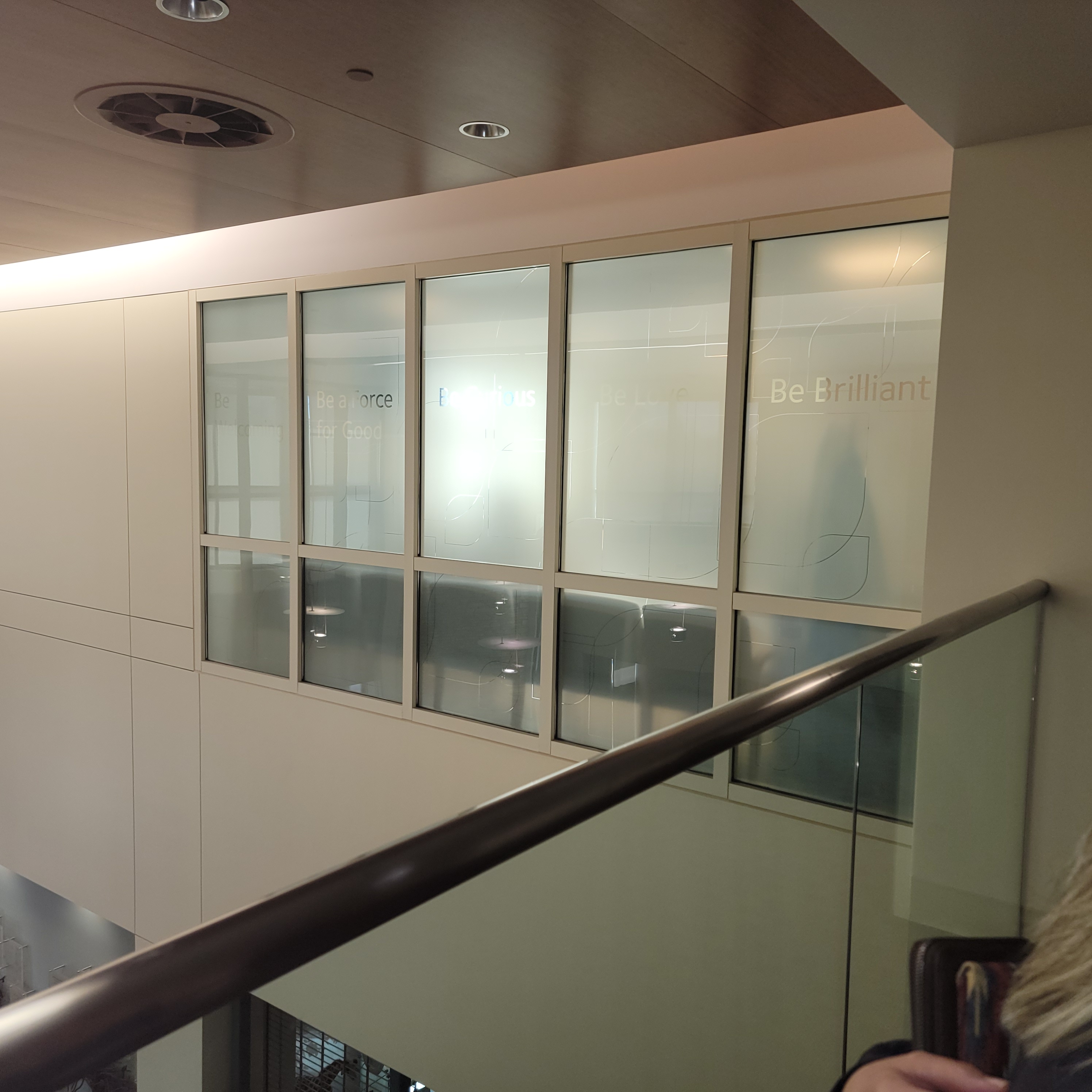

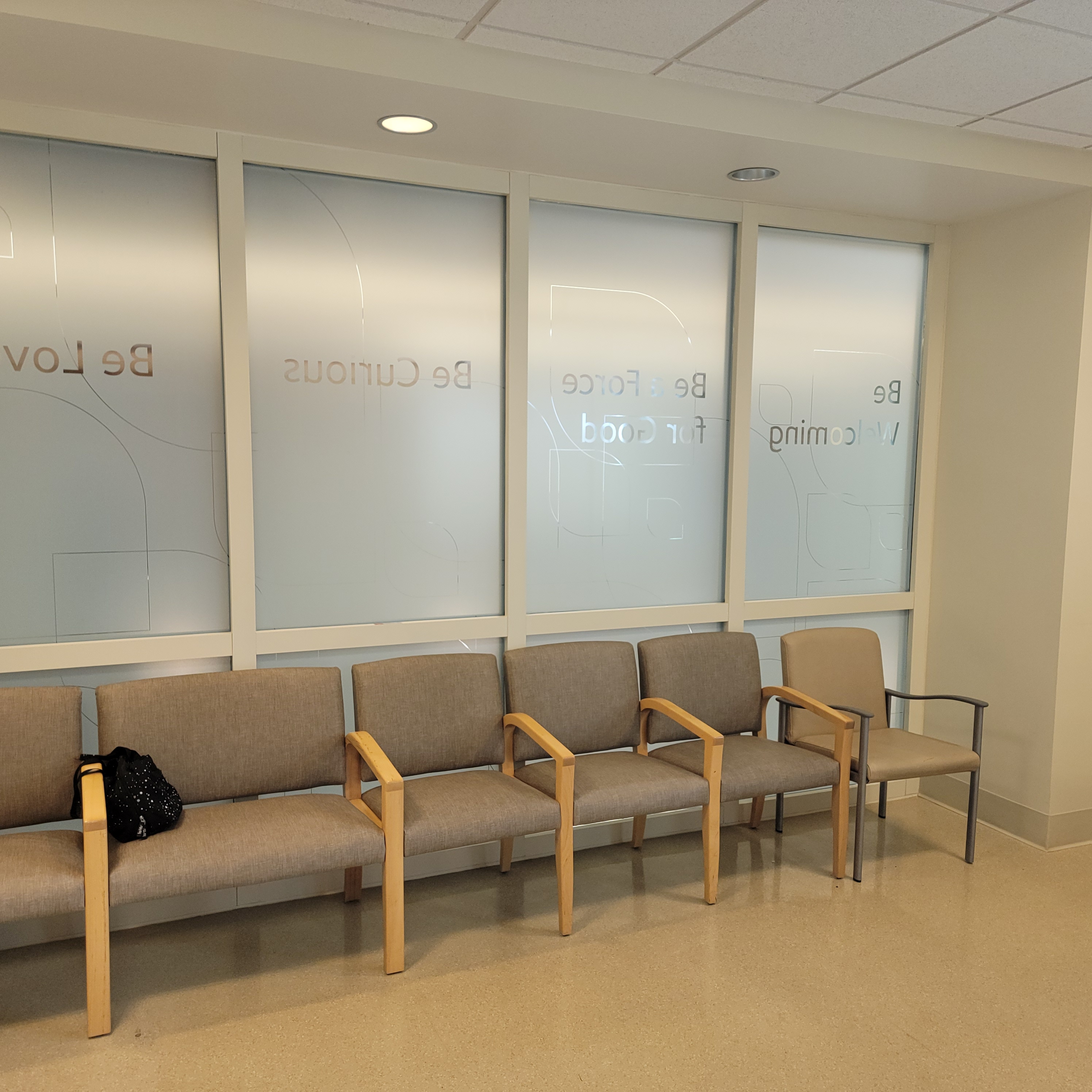

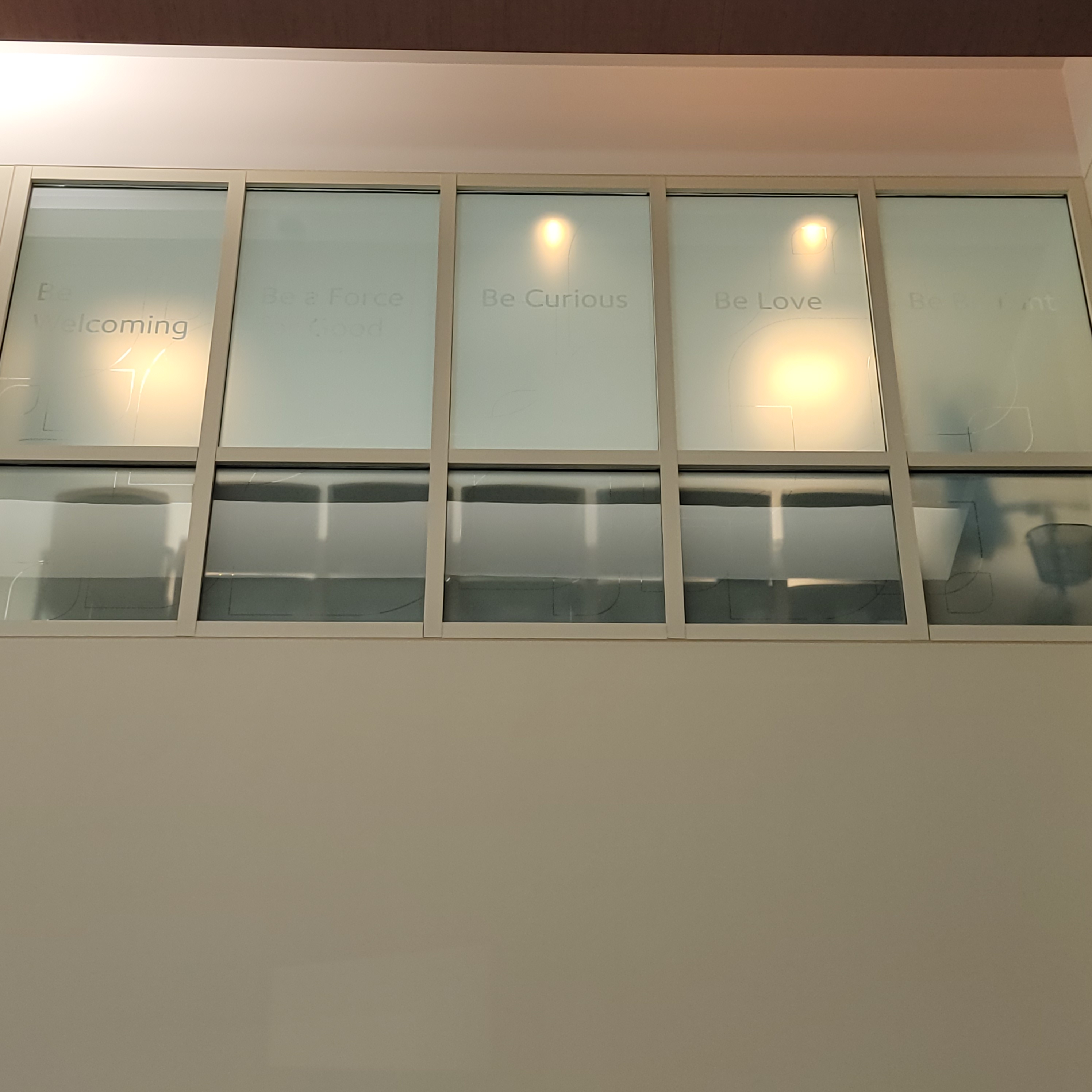

These images show (it's almost impossible to get good photos) white printed 50% on clear with the text and images knocked out to be clear. It worked well for privacy. Make sure they are aware of front lighting vs backlighting will make it look very different, not bad just different...

You could easily test it, but from the samples I've seen in the past EcoSol inks tend to be very thin & saturated but transparent, meaning they wont give you the same hazy effect that a thicker UV ink would. Think you would get a similar result to the latex photos attached earlier on in this thread.
