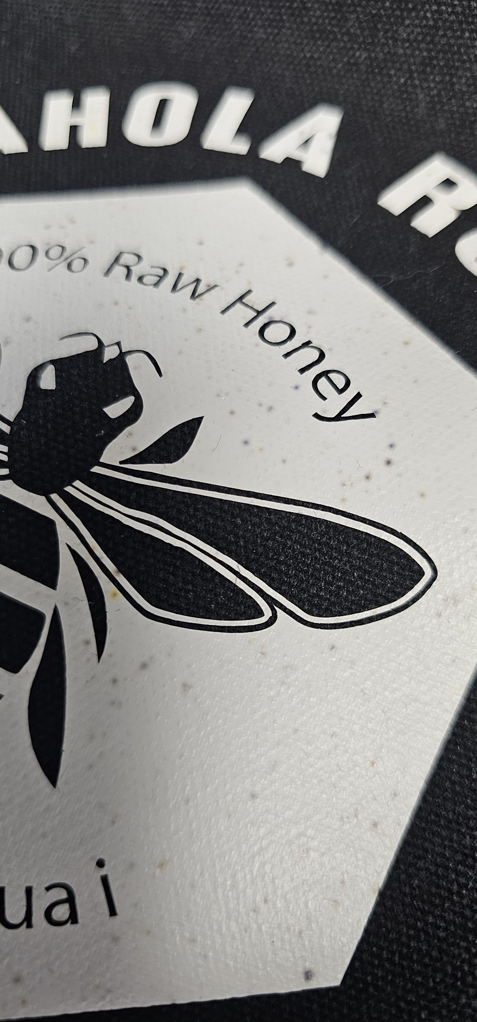

It's pressed onto black canvas tote bags. What's the other brand you switched to if you don't mind me asking? I'm sending to Siser for answers as well.Odd and curious. What's the substrate it's on? I used to use a ton of easy weed and never saw anything like that. (I've mostly switched to a different brand that I like better, but still get it occasionally). Usually when you have dye migration (bleed through) it's a consistent change in color across the material, not splotchy like that. Unless maybe that's some sort of weird blend with just little flecks of polyester in it I don't think that's it.
This stuff that they call Ultra Flex.It's pressed onto black canvas tote bags. What's the other brand you switched to if you don't mind me asking? I'm sending to Siser for answers as well.
We got these same “fisheye-looking” spots when laminating clear FCO letters to the front of white acrylic using Weld On 3. We were attempting a push-thru look using clear letters on white backer, instead of white FCO letters on white backer (which we do regularly on routered aluminum faces).
We guessed the cause was dust or contaminates between the plastics creating actual fish eyes in the watery Weld-On. We never figured it out, really. We just didn’t do it again.
May be totally unrelated
I will definitely check them out, thank you for the info. I'll reply if I hear from Siser.This stuff that they call Ultra Flex.

Update: After trying to pin me on material compatibility, press temperature, press pressure, time of press contact, they suggested new temperature, pressure and time.I will definitely check them out, thank you for the info. I'll reply if I hear from Siser.
