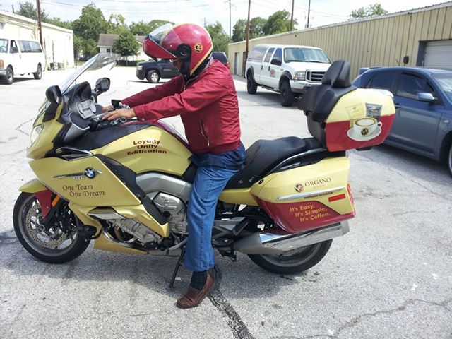

I found the Avery supreme wrap to much better on our bike rather than the Arlon. The Avery was much softer and easier to do the complex curves, including the helmet. We removed all fairings, fenders, disassembled the saddle bags. Lots of work but looked cool. And the customer is happy. The big tip was to have at least 8-10 inches more vinyl than the coverage area required and love the heat gun.
