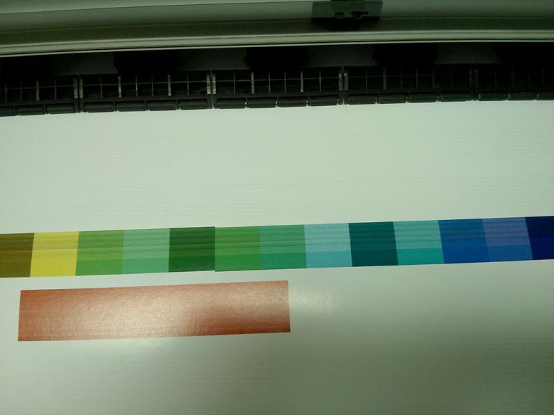

I have a mutoh 1204 purchased new from signwarehouse 7 months ago. We use the printer everyday and everything was fine until now. I started to notice horizontal banding on print, I did a nozzle check and there is a lot of missing lines for all colors. I tried to clean everything, apply cleaning fluid on a coffee filter and let the print head rest on it... I tried all that multiple times the last 3 days and the nozzle check is still bad.
The weird part is that if I keep printing for a while the quality will improve and it will start getting good toward the end of the print. Then if I let the printer seat for an hour or so the banding problem will be here again and I will need to print for a while to get better quality print with no banding.

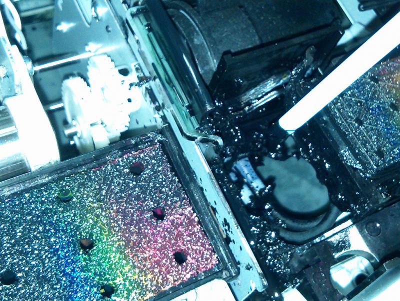

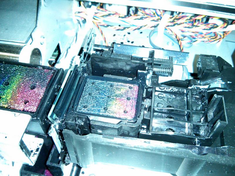

I opened the side panel on the right of the printer, I looked at everything with a flashlight and everything seems normal but I am not an expert. How do I make sure the head is align properly on the capping station ?
manu
here is some pictures

Is all this ink gunk under the capping station normal ? the printer is 6 month old...

That thing looks filthy... Until it is cleaned and functioning properly it will never work no matter what ink is used... Clean It...
manu
The picture shows the ink residue under the cap of the capping station. The wiper, top of the capping station and print head are spotless clean.

I just had a MS go bad 6 months after buying my printer and it filled the wiper channel as well as the lower motor area similar to what yours is. My wiper would not move all the way over. I clean mine 1-2 times a week and still had the issue. My MS was bad. My dealer which was Graphic Resource Systems in NJ stood behind the product and replaced my MS.

If you haven't messed with anything else on the machine, for the first 5 years or so 99% of the time it's the maintenance station, or more specifically the cap on the station. The rubber gets stiff over time and will no longer seal against the head. You can replace the cap only on the station for about 30 bucks, or the maintenance station for $280 to $380 off ebay if you are a little price savvy. Don't pay OEM Pricing, ($600) or (100)
