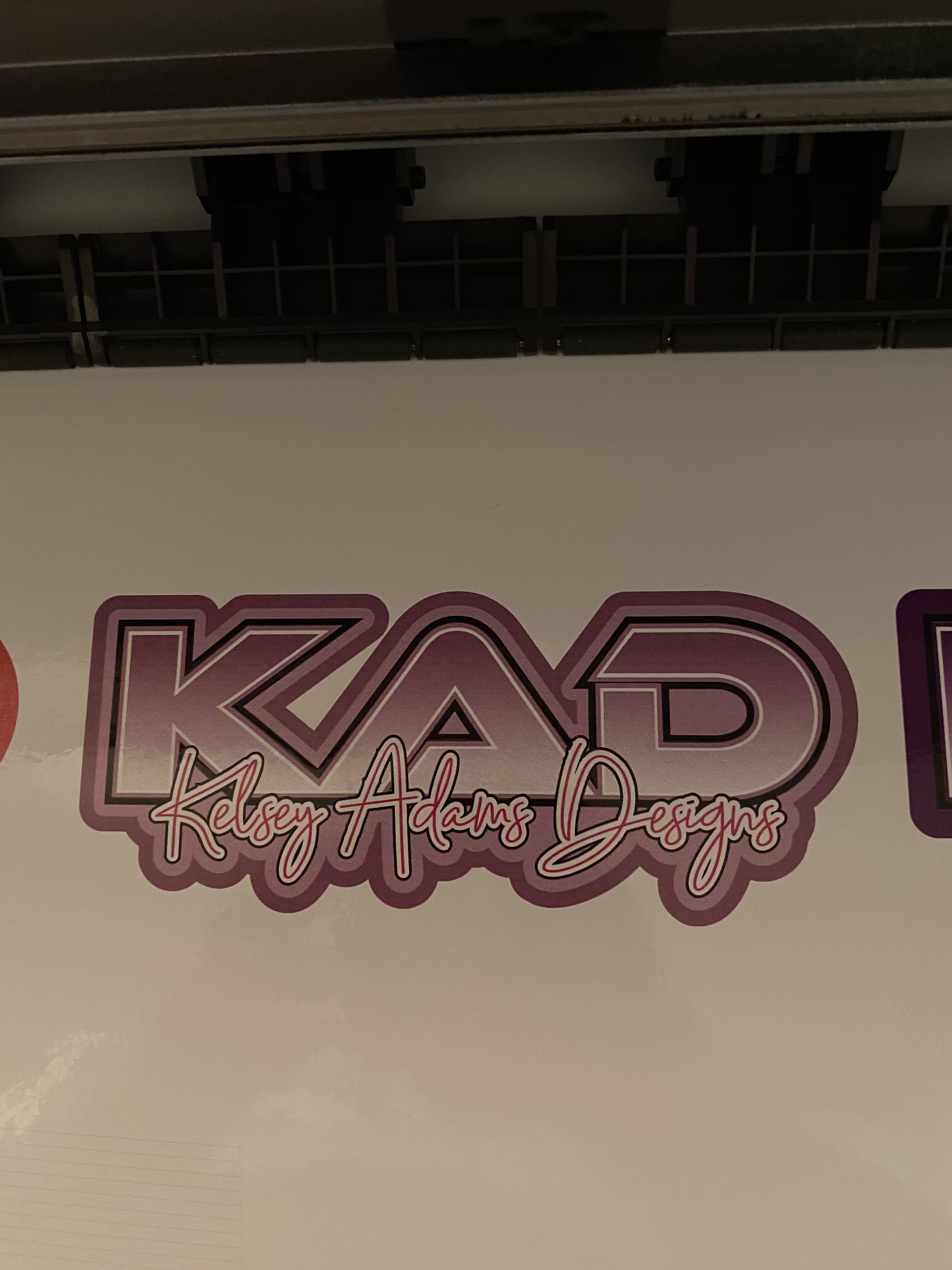

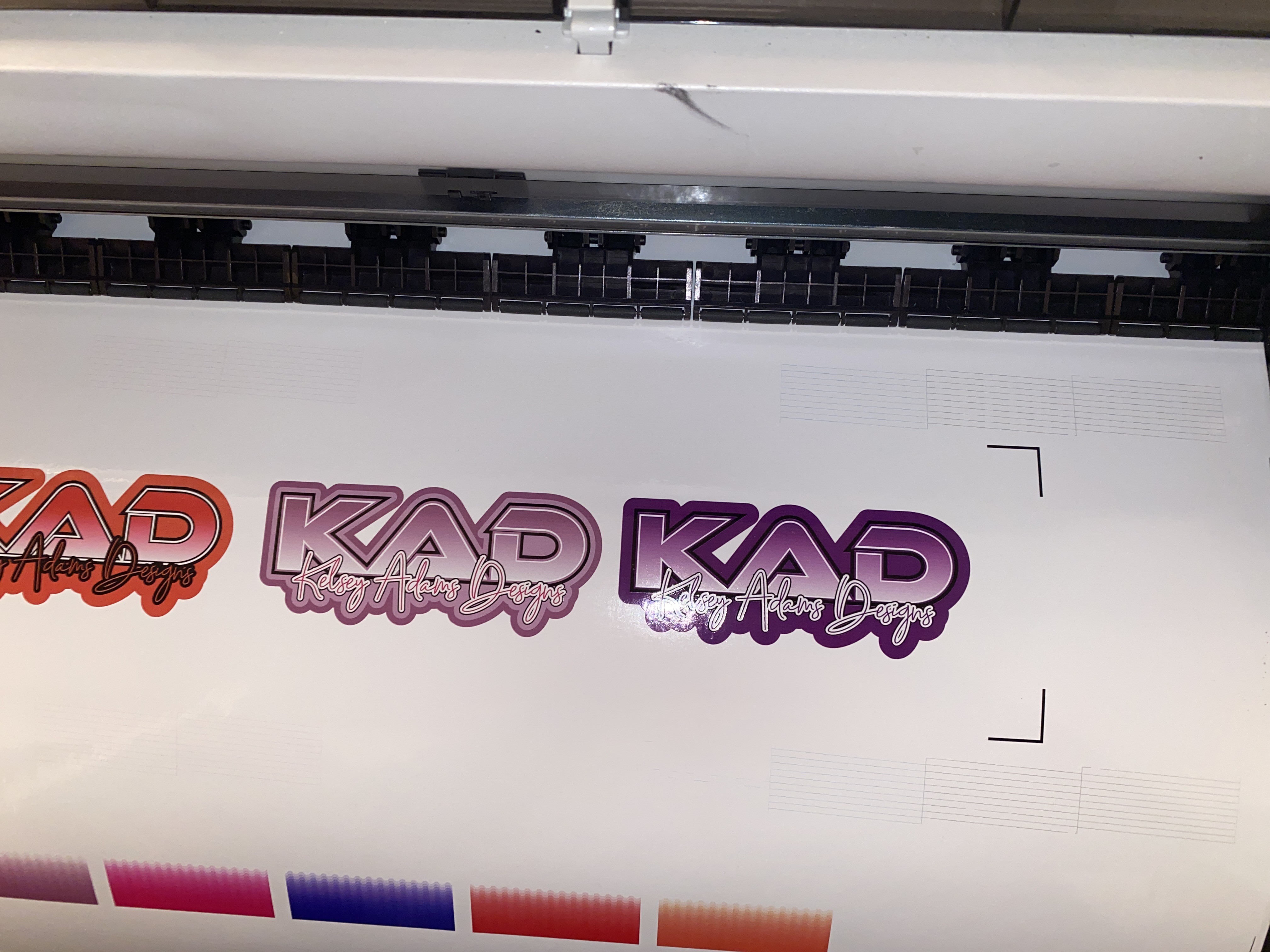

This is suppose to be grey. I also have one blue nozzle that is not firing at all. Could the incorrect color be caused by this nozzle?
For sure. The lack of cyan is shifting it towards magenta. You actually have a lot more printing than I realized. Since it's really only the missing cyan, I would suspect a bad damper in this case. Do you see air in the cyan line? Also, it's hard to see if the yellow is printing.
