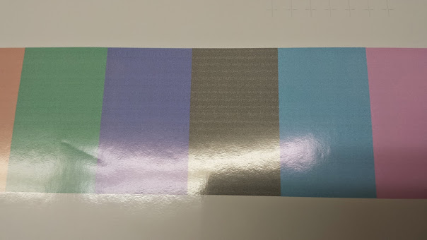

My Name is Luis and I have a few questions about banding. I replaced the printer head and the cap on the MS. I also changed the dampers, o-rings and caps. The printer is doing much better however I am missing only one nozzle (Cyan) and I have no idea why. The thing that really gets me is the banding issue. I have performed a feed adjustment with a 500 mm ruler and it looks great. Nozzles are firing but only one. The Maintenance Station hasn't been replaced at all but it seen to work just fine and I don't have any air in the lines. I did noticed that the black is not rich and looks faded. Starvation could be something to look at however the dampers are brand new and the MS Cap seem to be sealing just fine. I pulled ink from the MS tubes and I get all colors with no air bubbles. The image attached was printed while doing a micro check. The banding looks really bad and I am clueless on how to get it fixed. I also played with different profiles downloaded from flexisigs. Anyone with a similar issue and a possible solution ? thanks in advance.

I think I figured it out. After changing profiles I got a good print without any banding. :thumb:
