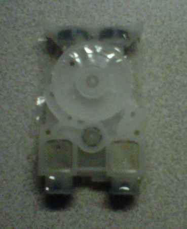

OK I went to the solventinkonline and loked up dampner for mutoh vj1614, the ones pictured there do not look like the one in the machine...mine has a dual line setup on the supply side, the one pictured are for a single line set up. where do i get one of these?
Stealth Ryder
Again, a Mutoh Dealer... The part number is DG-41543 and it most commonly called a Valve Head rather than Damper...
And yes, to me 43 this is still a kid... Heh Heh Heh
All anyone here is doing is trying to help, at least that was my intention... If anyone is going to dish out advice at least give correct information...
