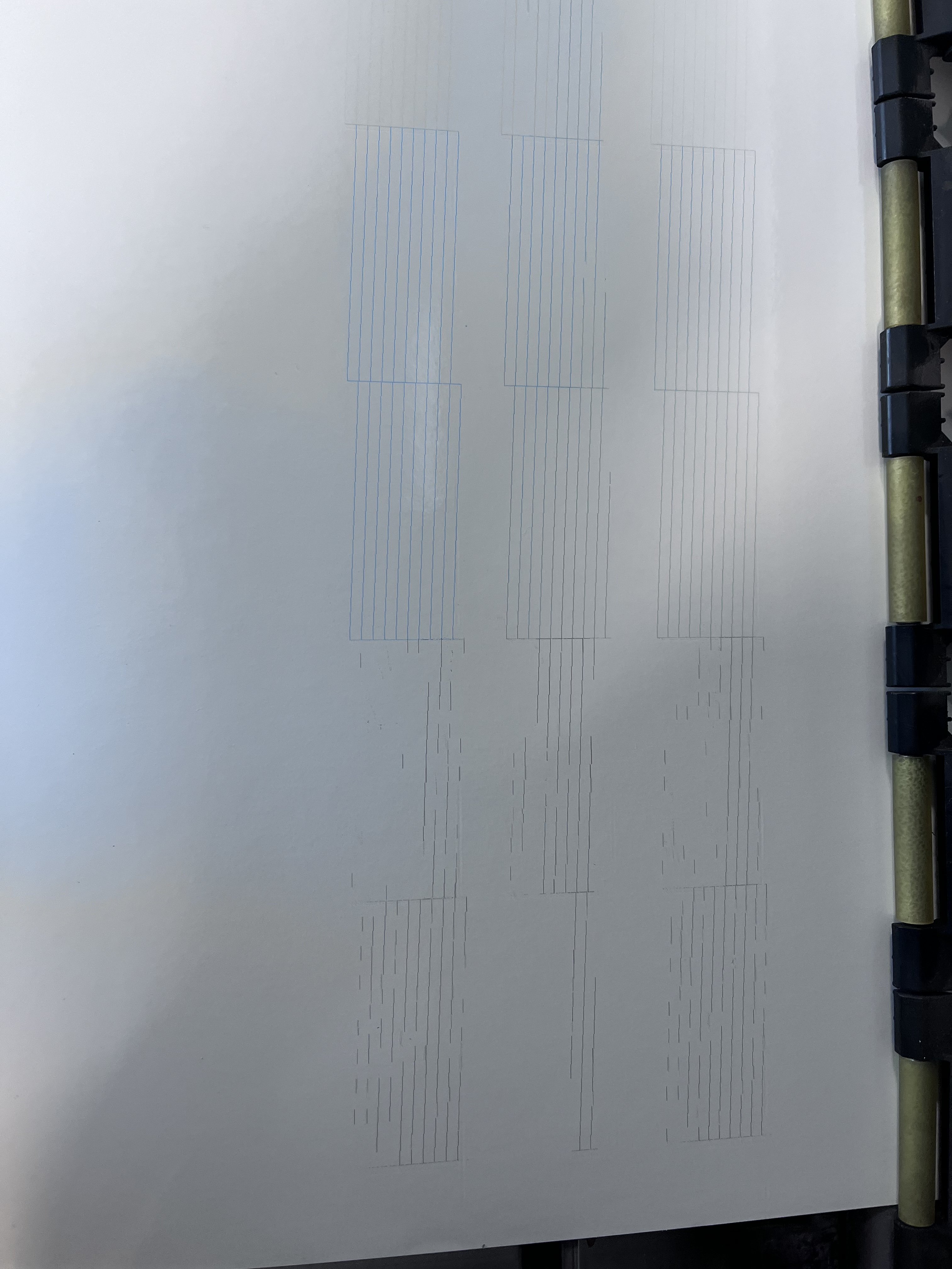

I've been chasing this issue for a bit and seeking a solution. I've changed out 2 sets of dampers for black, 3 different maintenance stations and can't get rid of this issue. No issues ever with any of the other colors, just the black channels.
The most recent maint station is OEM and has great resistance when drawing ink through with a syringe, but the black continues to print a broken pattern. I have tried soaking overnight, and not really any improvement. After many cleaning cycles, I can usually get the black to print ok to run a print, but then the second channel completely goes away again and have to run through many cycles, which uses a lot of ink. OEM Inks. This inconsistent pattern also results in banding for black/grey colors. The dampers are not OEM and that's going to be the next step, but wondering if anyone else has faced this? My prior Valuejet had the same issue, and we ended up purchasing this 1624 because we couldn't get the issue resolved.

If you're using the new Mutoh inks that come in the black ink cartridges, we've been seeing this problem in the DX5 based ValueJets. The solution is to switch to 3rd party ink.

So another update; I swapped out the dampers from the next channel over and black is printing solid in the new channel, but now my cyan/yellow are broken in the swapped channel. Assuming this means the printhead is fried?

Not necessarily. What we've found is the black tends to slowly fail so if you can flush the black channel and get it printing like you mentioned above and then put the 3rd party inks in place, it should fix the issue. We think that the black just slowly clogs in the head which is why it can print in another channel for a while before showing the defect.
