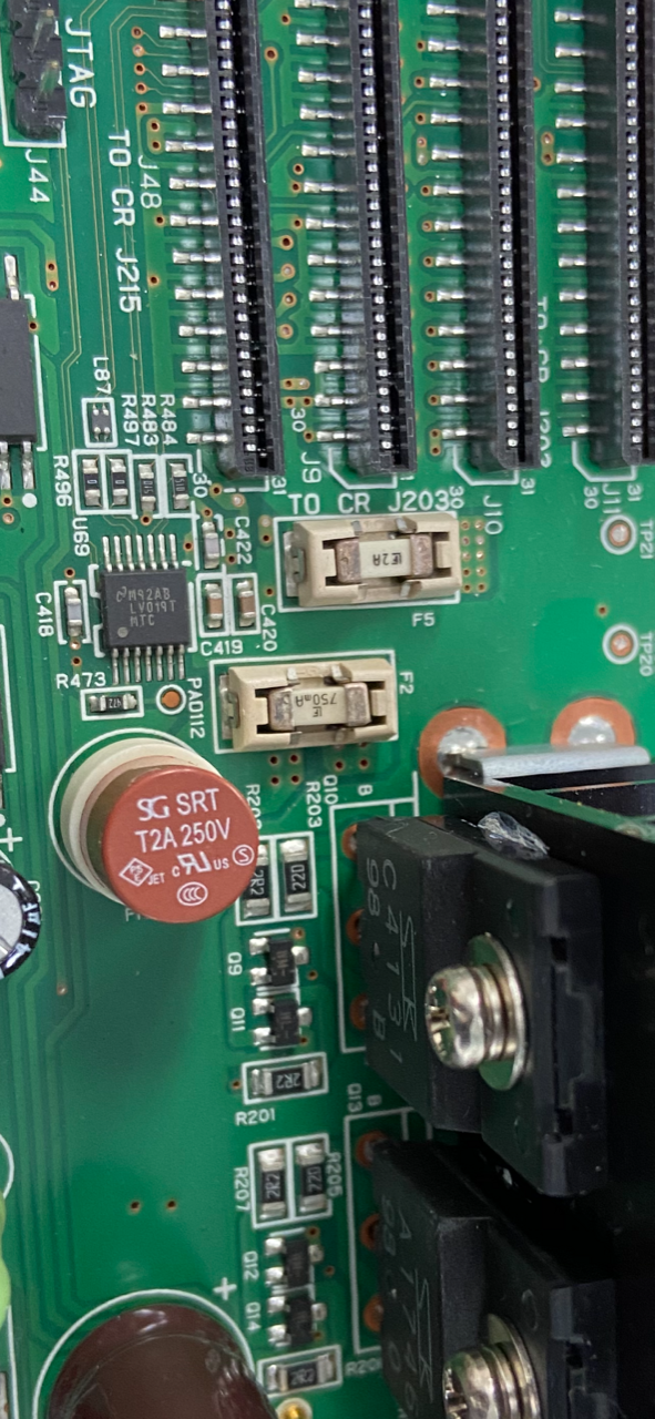

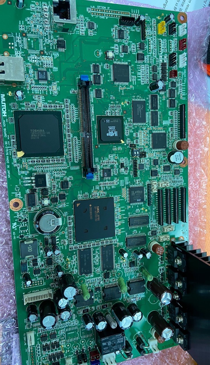

I do have a head that fires. I thought the tic tac…lol fuse was the white ceramic but I will look for the other that I understand is tic tac in size not color. I don’t know the difference in the boards but the white ceramic that is about a about a half inch. Now on the hunt for the smaller. Thank you. You make me optimistic!!!
henryp
The printhead fuse on the mainboard is normally labelled F2 and is rated 750mA
