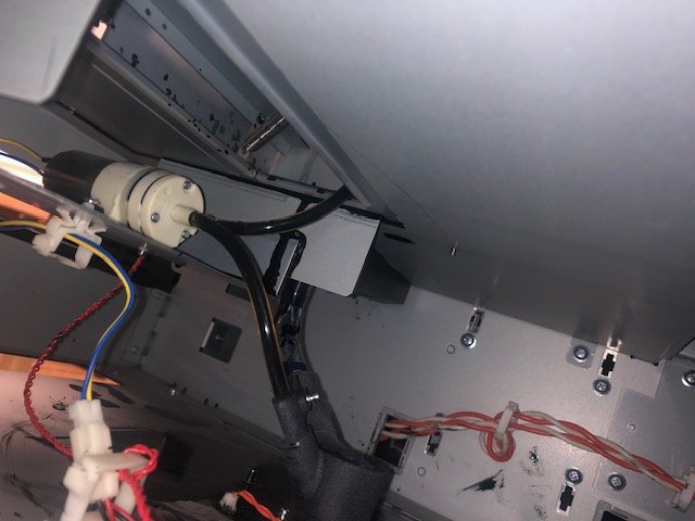

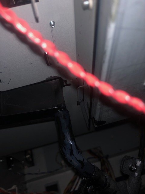

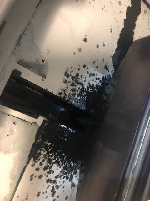

Hey guys I heard some gurgling during a cleaning cycle and have noticed that the rectangular black box (I believe spitting box) is full of ink and has overflowed inside printer. The large clear tube coming from it has no fluid in it. I removed the tube from the black box and the box started to drain. I also noticed that the two small tubes going to what I assume is a pump appear to have waste ink in them. Is this likely to be a clogged waste line (the larger one)? Anyone else had these issues? My warranty has ran out on 5-22-24! Will update with pics in a mintue

That was it... The larger tube was clogged, cleaned it out and the spitting box still would not drain. I removed the large tube from the fitting on bottom of printer and it was clogged there as well not allowing it to get air to it to drain. Got it straight. Thanks!
