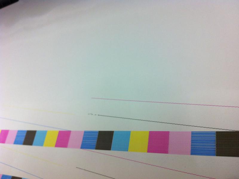

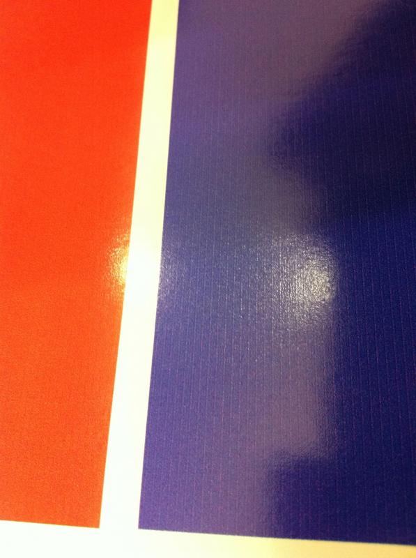

I've noticed that I've been getting some weird banding on my prints lately. It's not the worst I've seen, but on some jobs it's quite noticeable. I've attached some pictures.
Seems worse on dark colors such as blue and black. I don't notice it that much with lighter colors.
I've tried playing around with my heat settings, I've tried different color profiles, I've tried cleaning, I haven't been able to knock it out.
My nozzle check seems to look good, but notice how cyan looks a little funny? Like, the nozzles are all there, it's just a little sloppier than the rest of the colors. It's been that way pretty much since I replaced my heads. I'm not sure if it's a problem or not.
Let me know what you think and what it could be. Thanks!

There are basically two reason nozzles get misdirected.
1. Ink drying on the nozzle opening, in which case it may take some extended soaking to soften up enough for the wiper to remove.
2. Damaged nozzle openings.
You can see in the photo that some black nozzles are not lined up in the diagonal pattern.
They should all line up.
You are also missing some black nozzles.
Step may help, but only as a mask.
Soak for a few hours, if you dont see any improvment, soak for a few more.
If no change at that point, you probably are not going to recover or realign nozzles.
daenterpri
Gotcha. Thanks :)
That black diagonal issue was a glitch. My current nozzle checks and even my previous nozzle checks didn't have that.
I believe that my Cyan color has looked like that since I replaced my heads last month. Think maybe it came damaged somehow? It's hard for me to know how long this has been going on because, as I mentioned, most things you cannot see it. But when you print solid colors, you can see it.

Yes, but I am missing 6 nozzles in the magenta that cause the white strikes/banding :-(
Did a head soak for 6 hours again. Resulat was that the yellow was contanimated by cyan in the damper. Had to purge/clean several times and print full yellow to get it back on order.
I have to wait for the new head and go from there.
Probably the piezo elements in the head are dead for the missing nozzles and also the NWC might be damaged on the black head too.
BTW NWC stands for NON WET COAT.
This is the last brownish coating on the printhead surface.
Its job is to release the inkdrop from the nozzle in a perfect drop shape.
If the NWC at the round edge of the nozzle is damaged (by paperjams etc) the inkdrop exits the nozzle but the last part will stick to the nozzle exit and can then deform in shape and therefor become less straight and exits the nozzle at an angle. Also this cause the drop to splatter more.
