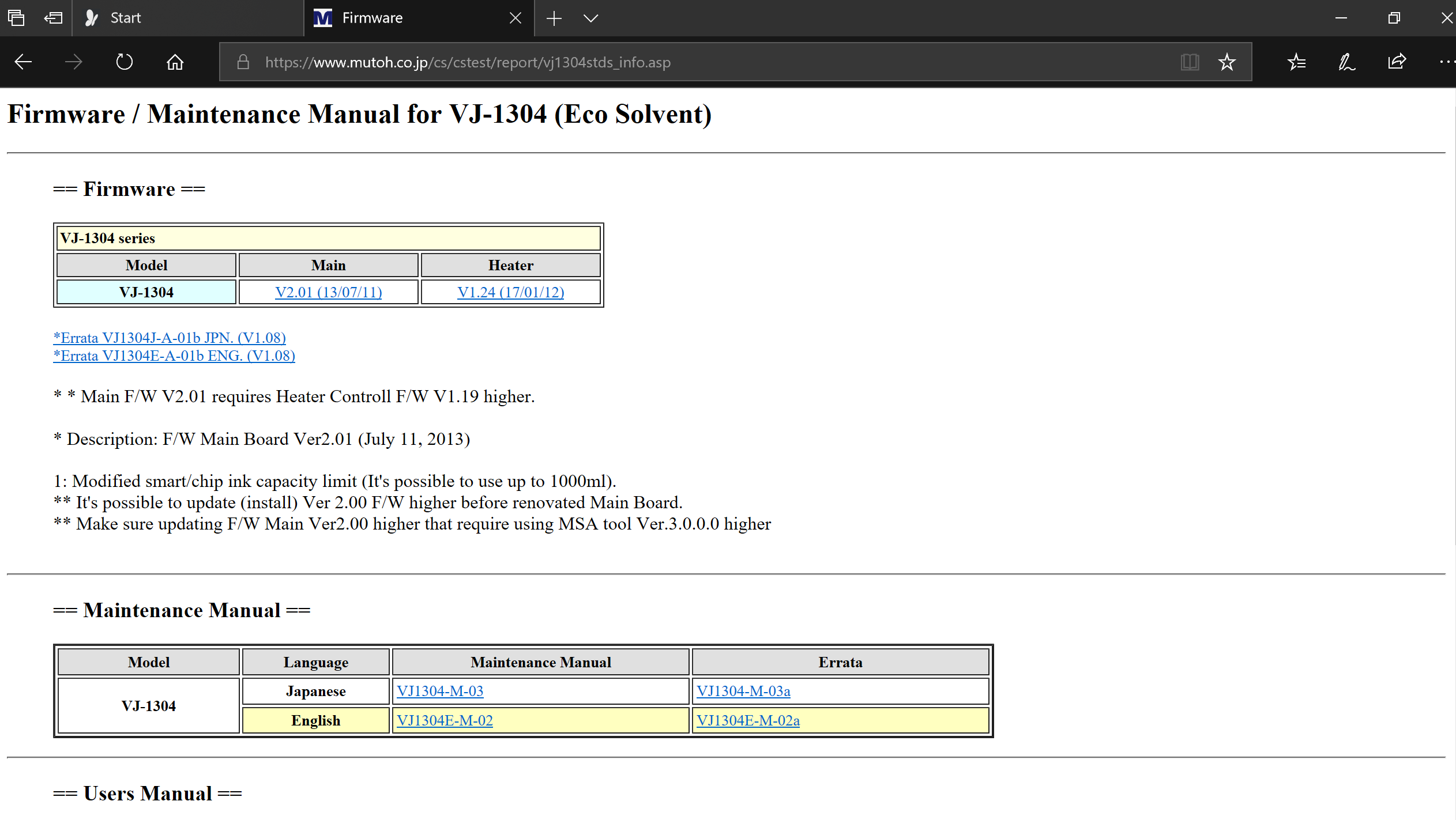

Thanks henryp, I'm fully aware of that. However the smart cards supplied with the 1l eco ultra ink bags will only run in the 1324x era machines I'm told. Reading the firmware bulletin for the 1304 I believe the latest firmware will allow it to these new cards, but can't seem to get an answer as to whether the firmware will work on my older machine?
The latest firmware, V2.01 will allow you to use 1000 ml inks. I could be wrong but the way I understand the attached screenshot below, there should be no reason why this firmware will not work as long as you will be using MSA ver 3.0.0 or higher (btw, the latest version of MSA in now ver 4.1.9.

Binker
henryp...good shout, i had a similar bulletin which suggested this very fact. So, just a preliminary trial. I picked up another 1304 which by pure coincidence has the new firmware (although the old heater firmware). It does recognise the Mutoh gen' ink bag 1l cards and isn't throwing an error!! That's good enough for me to buy an adapter to try... As for non genuine inks, it came with 440's in it and non gen cards - also working. I won't know until it screams 'ink end' whether its seeing them as 440's or 220's but on the face of it all is good! Will keep Y'all posted on what works. It does have a separate print issue but I think that's one for another thread...
