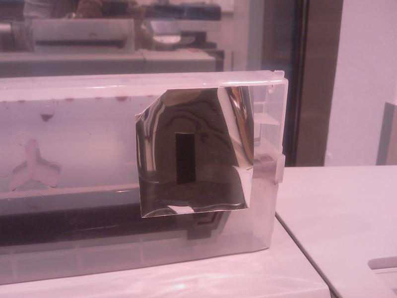

there is a sticker you should stick on the cardtridge. it is a reflective foil with a black, opaque rectangle. inside the printer is a pair of opto-couplers for each cartridge. if you have an original cartridge you can use it as a model for a new sticker, or peel it and use the original one. you should stick it in the same position as the one from the original cartridge.

iladi
sorry for the low quality image, but i think is better than all the yesterday talking.
