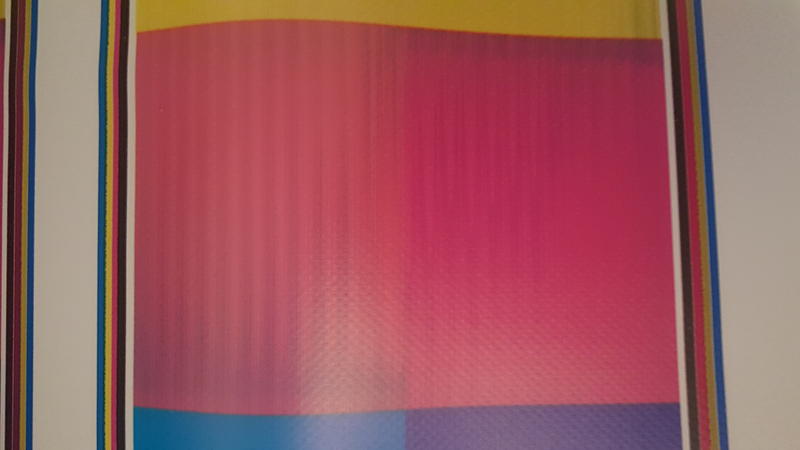

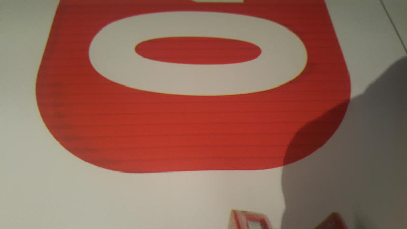

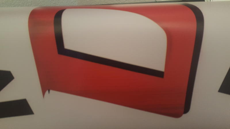

Hi friends .. if anyone has an idea why plotter does not print clean ... especially when print the red color leaves black lines

Dennis422
Welcome to the board.
Ako se dobro secam, mislim da ti se boje mesaju u dovodnim linijama. Ponekad ce boje da se pomesaju u stampacevoj glavi (Printhead) i mislim da se ponekad povuku nazad u pogresnu dovodnu liniju.
Uzmi špric i ivuci boju iz linija dok god ne dobijes cisto zutu boju iz zute linije, cistu magentu iz magenta linije, itd.
Bile je to prije 3-4 godine, ali i ja sam imao slican problem sa mojim Rockhopper-om.
Pozdrav.
I just told him to drain the supply lines because the ink is probably contaminated in the supply lines from the cartridge to the printhead.
It happened to my old rockhopper 3-4 years back.
