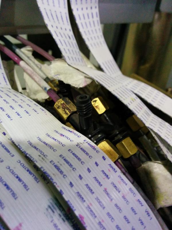

I would like to know if there is an accessory to purge ink straight to this point, I do not have any piece that connects here and my tought is that its a valve for manually flowing ink straight before the heads.
Anybody knows how is it called?
