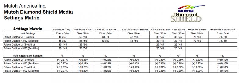

I have been playing with my new toy (I wish it was new), Mutoh Falcon Outdoor 48.
I have some material samples in my shop and I noticed that I'm having issues with printing a "smooth" even layer of ink. Tried searching online, but all of the posts are for newer Mutoh printers with 3 heaters. Mine has only 2. I tried the few settings, it looked decent on Banner material with settings around 40 C, sample roll of IJ35C looked not as good with 42 C setting.
I know that I will need to test most of the materials, but what I'm looking for are settings in general. Do I need to have the heater on the back higher that the front one or the opposite way? I'm just afraid to go too hight to curl the material and destroy the heads.
Any help will be appreciated.
Dennis422
Of course, as soon as I post it, I stumble upon this file. If everyone else needs it, it is posted now.
Any other pointers about printing with Falcon Outdoor?
