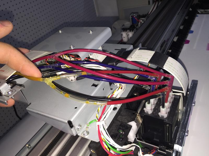

There are 8 ink tubes that come out of my ink head. There is 2 tubes for each color bc about 8 inches before the ink head the tubes come to a Y and split then go into the head.
I I ran the ink refill hoping that there was just no ink all the way to the head and when the ink refill was done there was about 4 inches of magenta looking ink in the tubes from the ink head where there should only be yellow ink.
Basically there is is the ink head then about 4 inches of magenta colored ink then no ink for about 5 inches then yellow ink. I'll take a picture when I get to work.
altereddezignz
The one I have my finger on should be yellow only and was all yellow until I started the ink refill

Ok from what i am told by mutoh here is the deal.
Apparently it is common for the magenta to flow back into the yellow tubes when the valves are opened in the back and allow the ink to flow. Now i guess this cleared any blockage that i had inside the damper. Well now that we pulled all the lines off the yellow and ran cleaner through them and reinstalled all of them we have working yellow now.
Well now i have no cyan. I have ink to the head but nothing will print. I created a 24 tall and 50" wide and let it run on a solid fill of cyan but didnt work.
Any ideas on this one since there is no way to run cleaner backwards through the head and ink will not flow backwards like it does with the magenta and yellow on the cyan.
