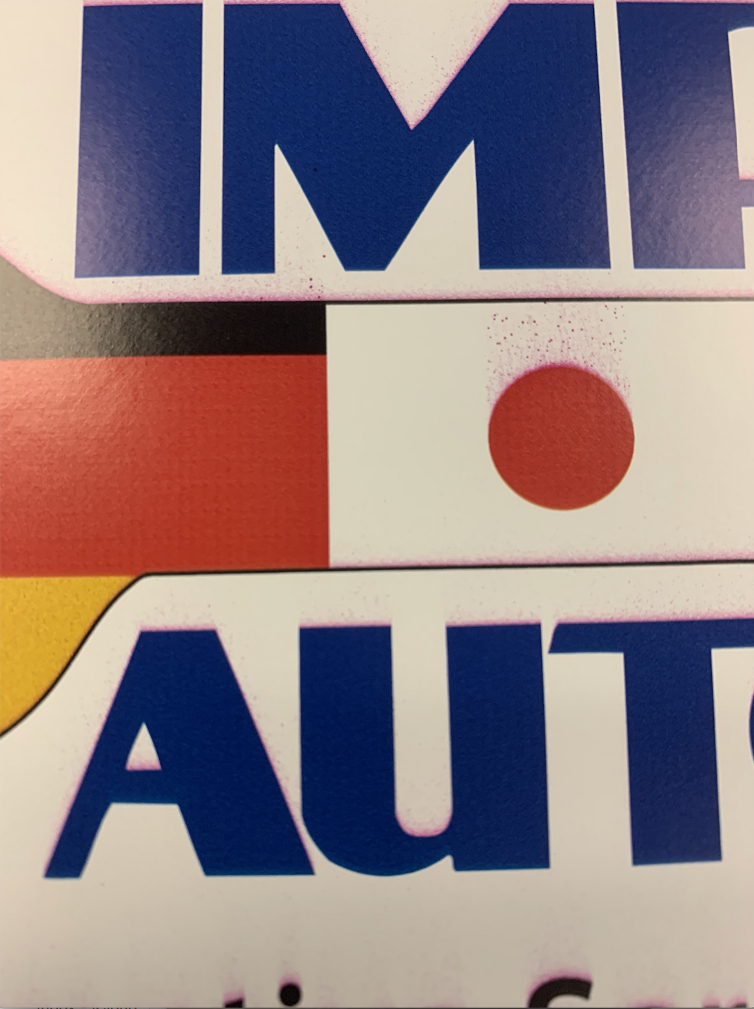

having problems with the magenta only, can't find anyone to work on this. any tips or help appreciated.

this problem seems to be an ink problem .. which ink are you using ????
Could you send me a picture of your nozzle test ..If the nozzles are deviated you must first correct it since this cannot be fixed with calibration.

If this is something that happened out of the blue, it looks like a damaged head to me. Have you had any head strikes recently? How old is the head?

machine is around 5.5 years old. the test pattern prints colors fine its just odd.

It's probably the head. You could try replacing the head cables to see if that helps at all but in my experience when it fires erratically like that, it's a damaged head. We usually see 3 to 5 years out of a typical head although I've seen them go as long as 13 years!
