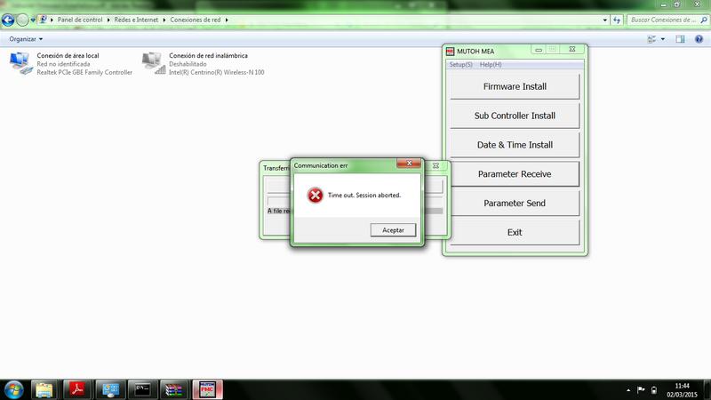

I'm working on a Mutoh ValueJet1604, firmware 1.19. I'm using "MUTOH Maintenance Engineer Assistant(v1.09)" on it to get "Parameter Receive". Mutoh is in "Board Manager Mode" waiting for commands. Then, there is a comunication error as you can see at the picture below:
attachment.php
Display shows: data timeout / transfer failed.
I'm working on Windows 7 Professional. Ping is done and there is communication between my laptop and printer. 2 ethernet cables have been tested.

First - disable antivirus and windows firewall.
Or try to connect from WinXP PC.
This program uses old protocol of connection that is blocked by firewall.

Hi everyone and thank you all for your help.
I want to do that to downgrade the firmware and install compatible inks.
So, I found out if you pass the firmware 1.08 on ValueJet, it's impossible to downgrade (Mutoh's protection) unless you change main board.
Please, if someone have another idea I'm all ears.
