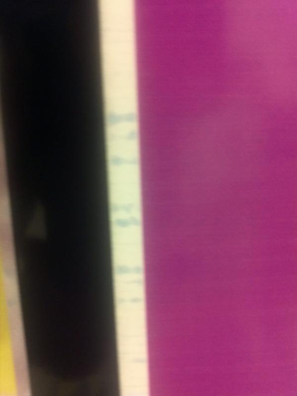

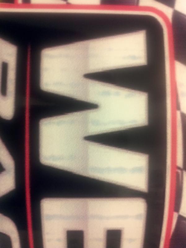

OK. After trying to replace the dampers with no success, I now have a printing problem. I am getting what I would refer to as very light but very noticeable cyan colored horizontal "splashes/raindrops". Any ideas what has happened. Have ran multiple cleanings. Is obviously most noticeable on areas of white. All help is appreciated.
Here are pics.
