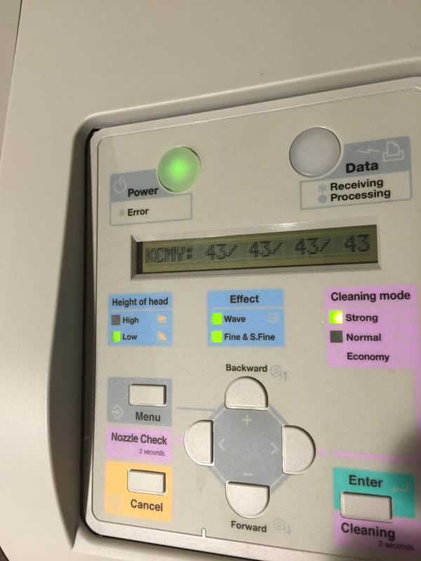

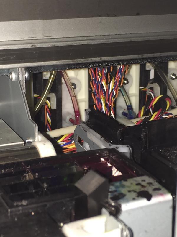

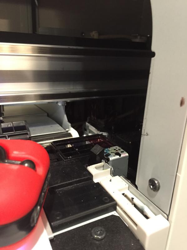

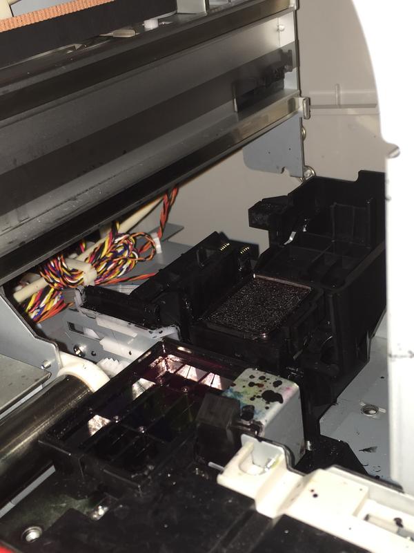

I went through the steps you told me and did the normal charge, did a test print with a little ink spitting out. The Magenta line look like it charged a little, but the rest look like there is ink & air spaced out through the line(see pics). I did a couple cleanings, went back into troubleshooting mode, did another normal fill without any different results. After checking out the lines coming from the ink cartridges, it looks like there is still cleaning fluid in the line, so I'm not sure how any ink has moved from the cartridge to the lines at all. I checked the ink levels and it shows 43% on all 4 of them---I'm beyond frustrated with this machine. I was told from the previous owner to do a head soak(not sure how to do that either), and that I should manually pull ink through the lines(again I don't want to mess that up). Any more help would be greatly appreciated!!!! Please take a look at the pics--maybe you experts can recognize something I'm not!

It's pretty common for a cap top to go bad on used machines after they are flushed and sit for a little bit. It looks like it worked a little bit but it is probably pulling a little bit of air which is causing the pump to not be able to pull at full force. Give us a call and we can help troubleshoot a little further and get you the parts you might need. 303-733-6671
