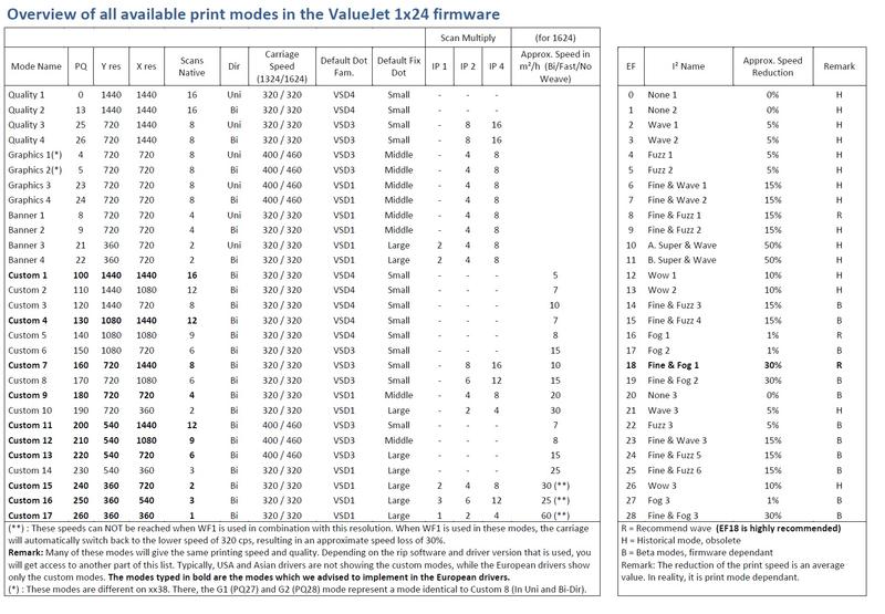

I have been tweaking some of my print modes in Signlab VPM, looking to improve performance, speed and quality for some of my media because of lack of available print modes for VPM
To understand it better does anyone know the difference between Wave 1 and Wave 3...I'm guessing speed.....I have found the attached that explains, fog, wow, fine, none, etc which basically is the pattern of the print band coming from the head.....
Not finding any info on the resolution settings, for example, Graphic 1,2,3.... Quality 1,2,3 etc....any insight on these would be helpful, they are all 720X720

I have some info. It can be helpful for you...
