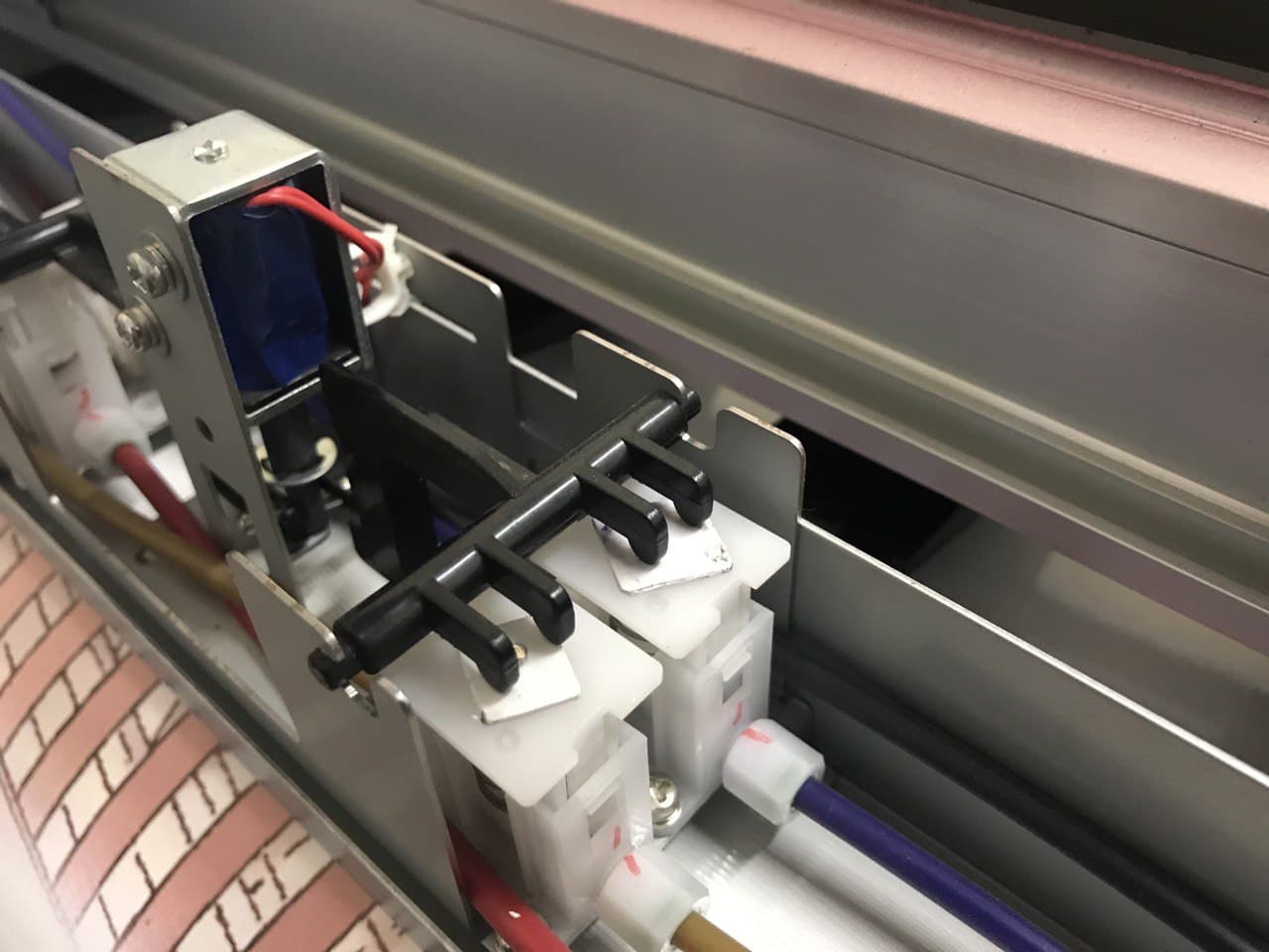

VJ1324 printer model has a constructive problem. It is blocking valves which located in ink lines between cartridges and printhead. I saw some valve does not worked properly and do not open. So, first of all check the valve on problematic ink line. Temporary (or permanent) solution can be to place part of plastic sheet on valve needle. As on the picture. It goes a needle upper and open the valve.
Jaime IL
Did adding the plastic on the valve chokes work for you? I just tried it and still have no magenta, I am at a loss.
