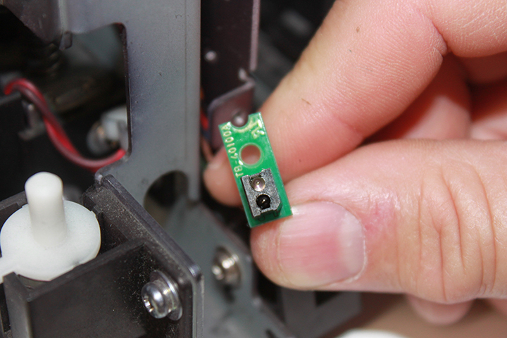

I have a VJ 1624 and I am new to the Mutoh machine. It was printing great then all of a sudden I am getting the error "undefined Media". I cleaned the sensor and everything else and I still get the message. I rearranged the stock to the left and right thinking maybe that was it. The stock is 54" wide Orajet 3651G Clear. When my carriage goes across to initialize the stock width it now stops half way and them continues on? I don't remember it doing that before? What are my options?

There is no way to turn it off unfortunately. You might also need to clean the media width sensor. It's the sensor on the front left of the print carriage. Ink builds up and covers the optical sensor so it misses the edge of the material and can't measure.

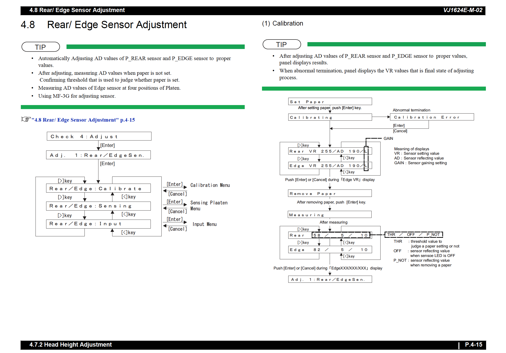

If the problem is with the rear media detection sensor, you will usually get an End of Roll message or something similar. The problem could more likely be the media edge detection sensor mounted on the left side of the carriage. You can temporarily bypass this sensor just to get you going if cleaning does not fix the problem. In the User Menu, set Media Initial to OFF, this setting will also allow you to manually input your media width.

In addition to suggestions above, consider recalibrating the edge detection sensor for the specific media installed. Most media detection sensors have trouble registering clear substrates until this is done. Changes in ambient lighting conditions, etc can also error despite the same media being used all along.
instructions attached.
