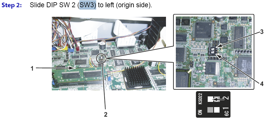

Hi Zapacituk,
Did you slide sw2 (on sw3) to the left ?
Caution: "After replacement of MAIN board assembly, make sure DIP SW position is set
so that overwrite-proof function is enabled. Otherwise, when wrong firmware is
installed, it may disable printer startup. In this case, MAIN board replacement is
required
." and if the wrong version firmware, mainboard may need to be replaced.
you need to install the good heater firmware too.
Cheers.
Xano-64
hi Xano, i didn't slide to sw3, where is located?
