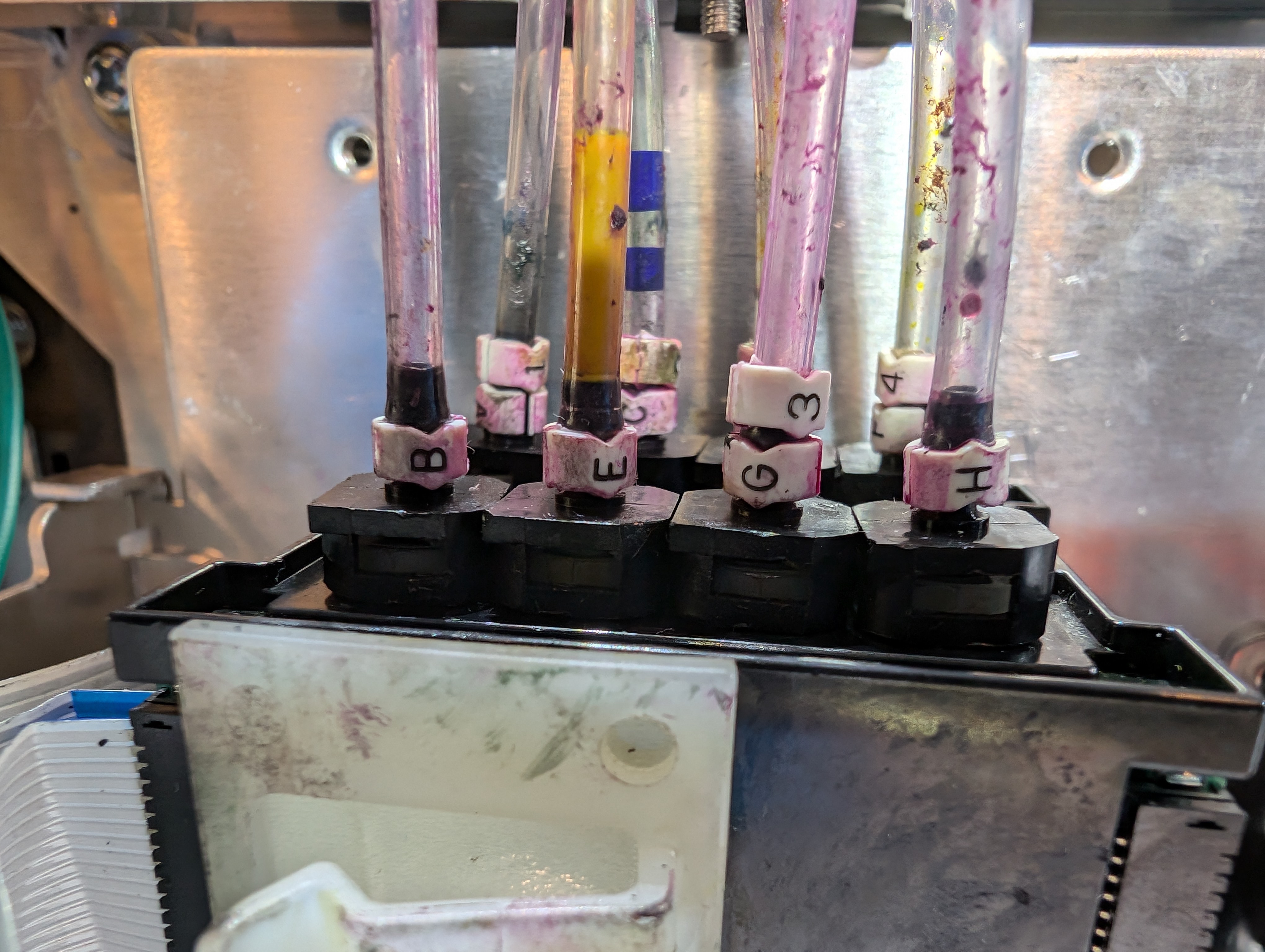

Long story is the head got stuck outside of the maintenance station and I was away and didn't know so it dried out. It wouldn't print at all so I just bought a new head and installed it. Now I can't get the new head to pull any ink into the dampers. My maintenance station works and I have tried Initial charge 6-7 times and I can't get any ink into the lines or the dampers. It's almost like the new head is clogged. I had Bell and Howell tech here all day yesterday and we can't get this printer to print. He thought it might be an air lock. We were able to use syringes to pull ink out of the lines so we know they aren't clogged. Here is a picture of the top of the head. We are not getting any error messages. I hope some brilliant person on this forum has already solved a similar problem. Thanks in advance for any advice.

first of all, try priming the dampers. You can do this by putting a little bit of cleaning solution in each camper with a small syringe. Be careful not to put too much pressure on the damper because the cellophane film on the outside can break.
The next thing to check for is air leaks at the top of the damper. It’s a twist like arrangement and you have to make sure it’s locked in place

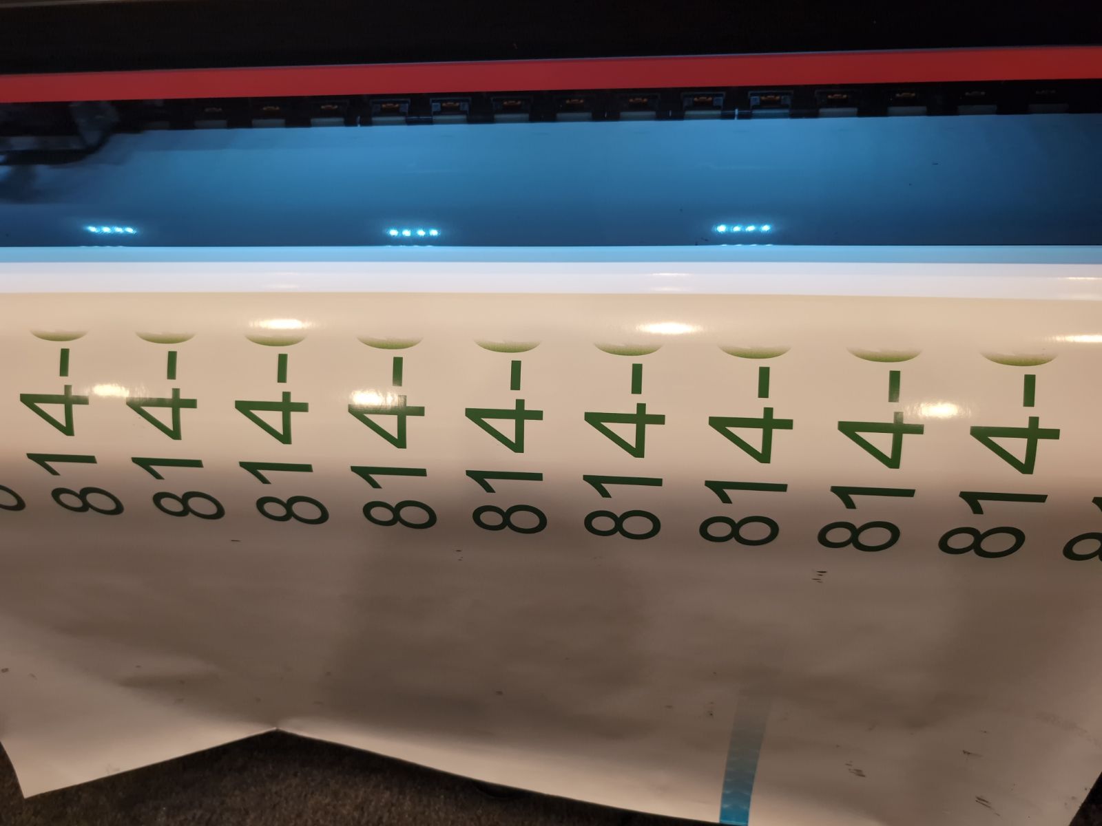

Dampers are empty - here is a picture of the head *before* I replaced the head and the dampers were full. The tech said he was able to pull some ink into one of the dampers but couldn't get it to print anything. He didn't replace any parts. Captop and felt pad not replaced. One thing that surprises me on these printers is that the ink line just snaps into the damper - I tried looking at youtube etc and I noticed other dampers have screwed in connections to the dampers.

I would pull with a syringe from under the cap top. And the cap to should be new if you replaced a head.
It's tough with some Mutoh printers and I don't remember that particular model, but if there are 2 hoses or not if so clamp one off while you syringe the other one. This will tell you if you've got a tight seal or not. If the syringe doesn't pull ink or pull the plunger back in, you've got an air leak some where.
My next check would be to pull from the bottom of the dampers and fill each damper. Then try printing.
I've also used a syringe with a hose to push- gently- cleaning fluid through the print head. Don't use isopropyl here. I've seen it react poorly with solvent inks.
Good luck
