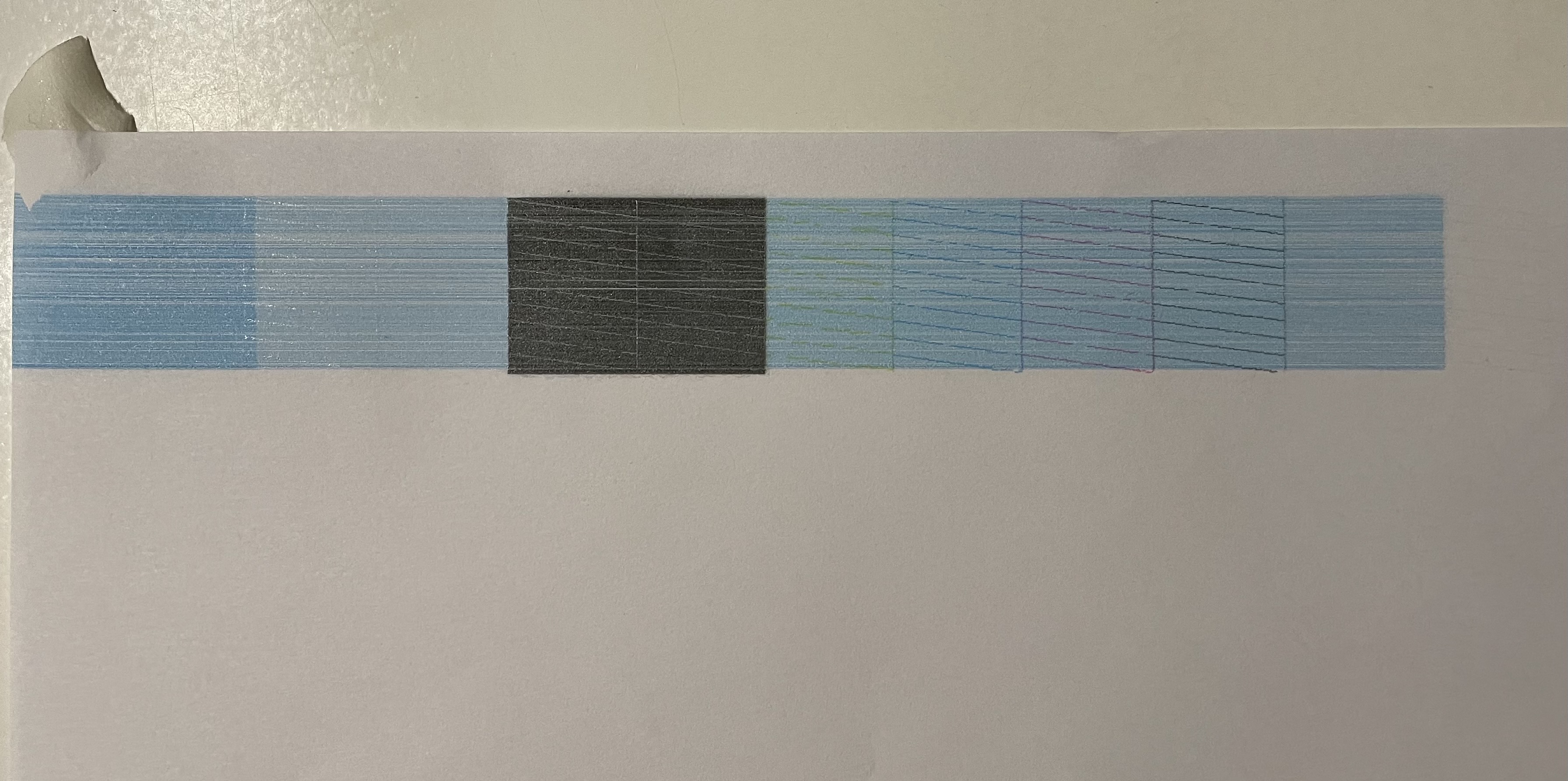

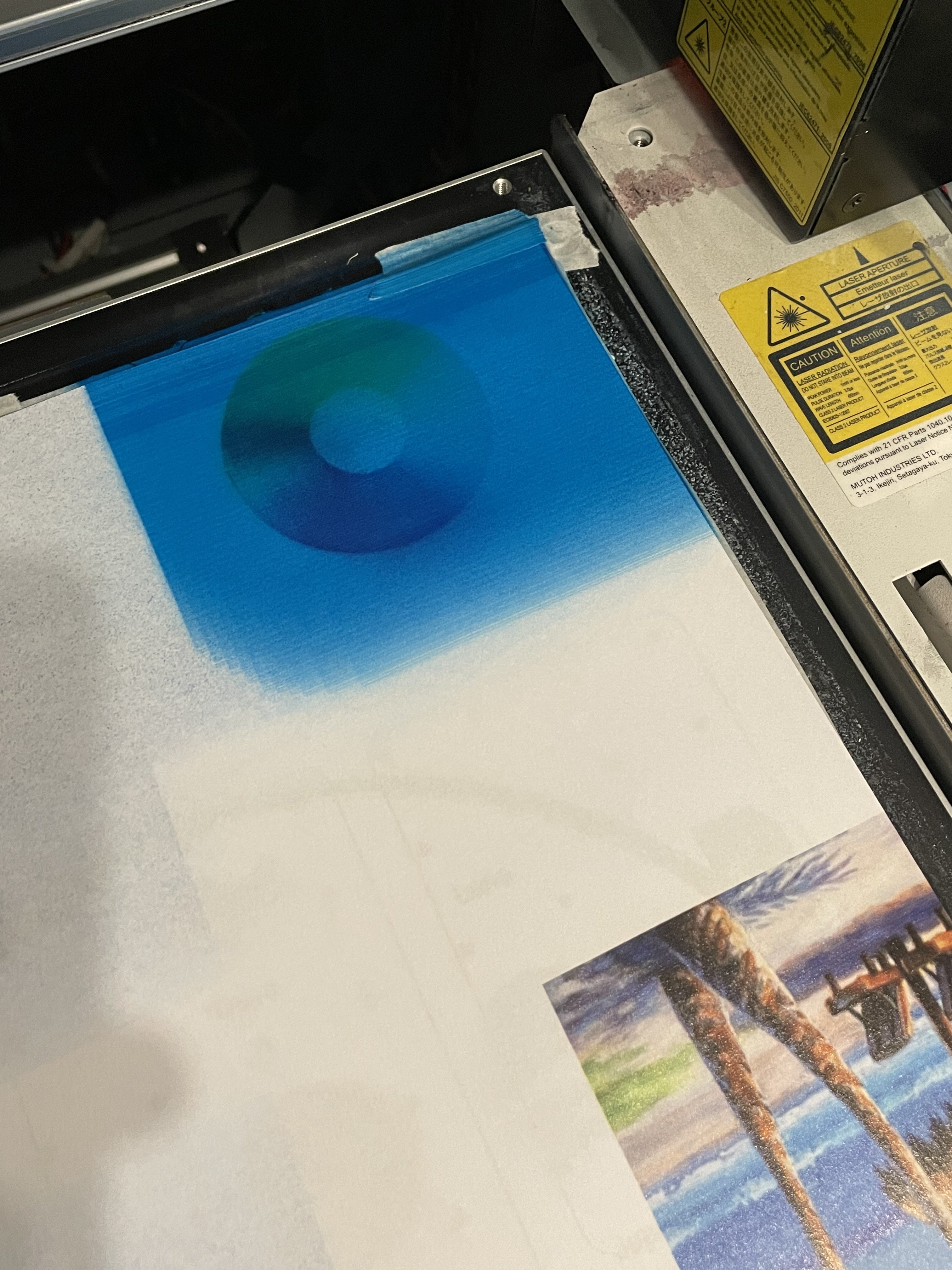

Hi, all, im from Argentina. I was using the machine (Mutoh 426VJ uv printer) without problems, until suddenly it started to print cyan on top of any print. It prints the colors correctly but always with a layer of cyan on top. Can someone help me out? any clue on what it could be ?
Here a Nozle Check and a color disk print.

heyskull
That looks like a deffective print head or head cable.
Sadly more than likely the print head.
Ours did this and was covering everything in magenta when the head failed.
