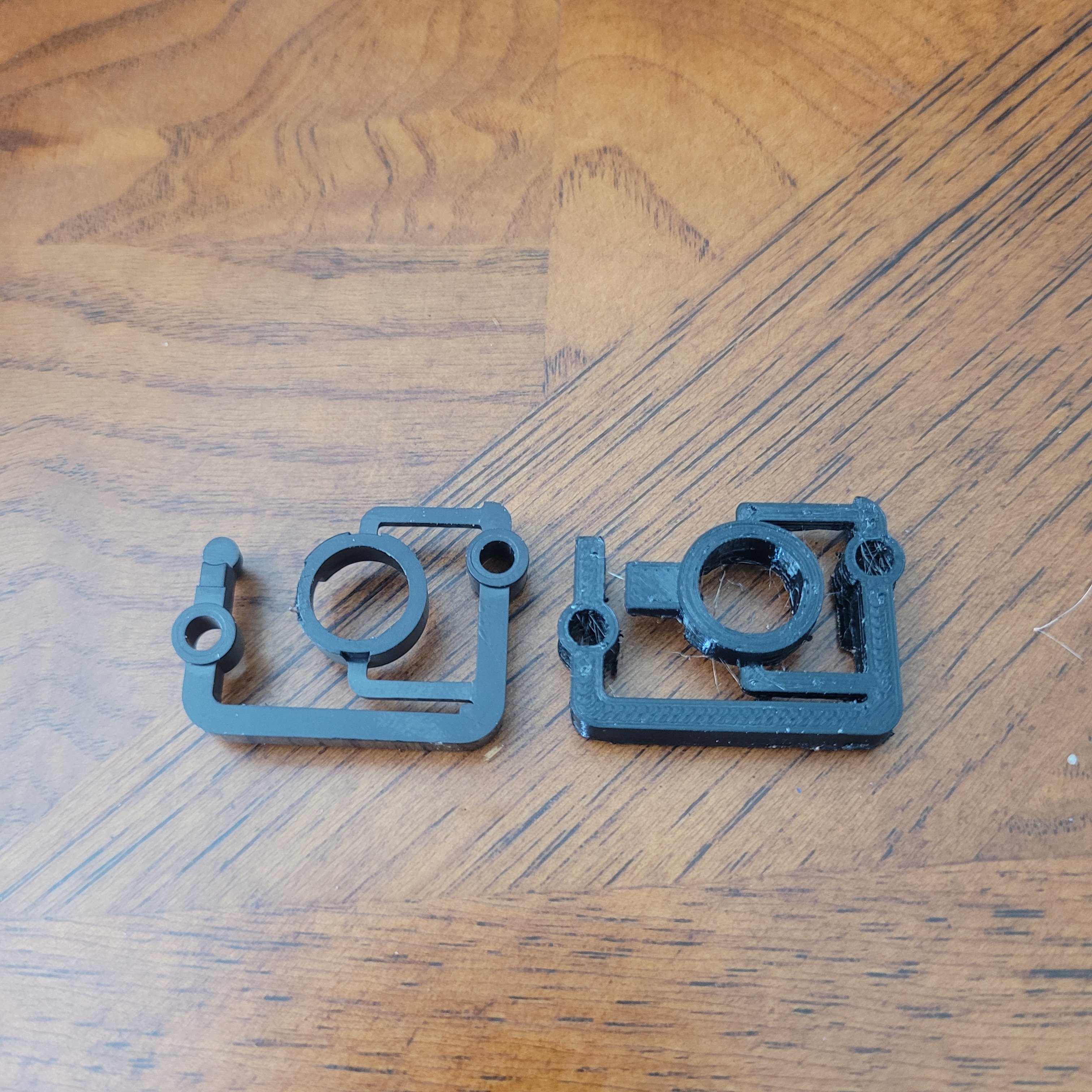

So my L360 front panel power button stopped working a while ago. Wasn't a huge deal as I just open the cover to wake it up. I wanted to get in to diag mode which requires the front power button. After removing the screen bezel I found the switch worked fine but the .02 plastic part around it was broken. Wouldn't you know it but you can only get that part with a whole new screen replacement. Found cheap used ones for $500 and they also looked to have a broken part around switch. Well I printed my own for about .10c worth of filament. If anyone needs one I believe they fit all the 300 series printers and I will make some and send them out for the cost of shipping. Here's a pic of the factory part an my printed part before I pulled all the little hairs off.

Now this is a benefit I can see with having in-house 3D printing capabilities! How did you set up the part - you have to 3D scan it? (Forgive my ignorance on the whole process)
Gettin'By
I think you can extrude an SVG and convert that to an .STL or .OBJ. Never done it myself but pretty sure I've read about it. I have done some light design work in Tinkercad as well. It's free and a little limited, but it does work.

You can build it from scratch with a mic for dimensions, I usually draw the shape in corel, export a dxf, and build up depth from there in something like sketchup, though there are much better applications for this.
I too am curious how OP went about it.
Subysti
just used tinkercad online. its a pain to use but free. Haven't learned how to use corel for 3D design.
