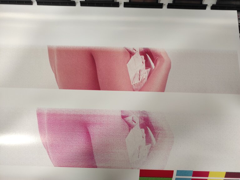

I swapped the heads, flushed them, pulled some ink with the syringe and printed this.. The bottom picture is unidirectional printing and the upper bidirectional.
I didnt align the heads, you can even see a bit of the test print at the bottom of the picture.. so there is some banding. Anyway, after swapping the heads the problem is still with black/cyan head.. ao its not the printhead but something else.
