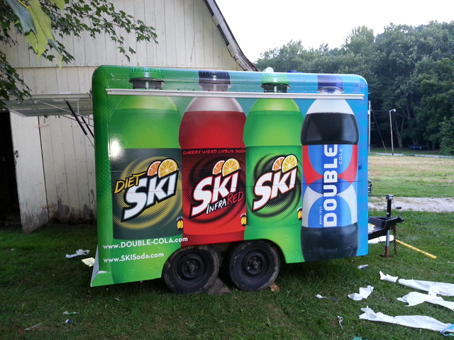

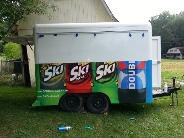

I'm having a terrible time on this trailer getting the top/top corners/sides to come out good. The corners are the worst part for me; I made relief cuts on them on this first side to make it cover and it looks like butt. I'm also getting severe wrinkles at the very top and some on the sides. The material is 3M Controltac (that's all I know; not sure what model it is). It has backing paper (obviously) and premask tape on top of it.
I've been applying the bottom section first and then applying the top using a bottom hinge. The only reason I'm using a bottom hinge is to make sure the 2 layers line up. Should I be peeling the app tape and backing paper off completely when I get to the top/corners/sides? I don't know what to do. :( It's so massive I'm afraid to peel it completely from the get-go.
Any advice on the wrinkles and corners would be UBER appreciated. I'll try to post pics:

I'd install everything except the corners with the premask on. You can yank the premask with the corners uninstalled and work them down.

I have installed stuff like this for beer and soda companys...they are meant for short term ad campaigns...apply as you are doing. Just heat the corner more and strech it over. This print is not meant to last more than 2-3 months anyway...in fact I think I installed one this summer that look like the same thing.

Does this change anything? I'm thinking about laying down the main flat panel (where the swinging door is) up to the hinge with the premask still on it. Then peeling it off and work it around the door edges and the curved sides/corners. Should I heat it and stretch it in the corners, then apply? Or just heat as I go to make it lay down?

he may have also given it to you because if hew brought it to me, I would have overcharged, or told him I have to reprint. That wrap should take no time at all. like others said, put as much down with the mask, peel it off, heat and apply. Just do your best... your friend can't really get mad at you because you told him you have never done it before...

yea i've installed the same crap on a trailer for a local beer distributer wasn't to bad but it was also flat ... lay it down with the mask on all your flat surfaces, peel the mask before curves and try to strech the vinyl as little as possible:thumb:
