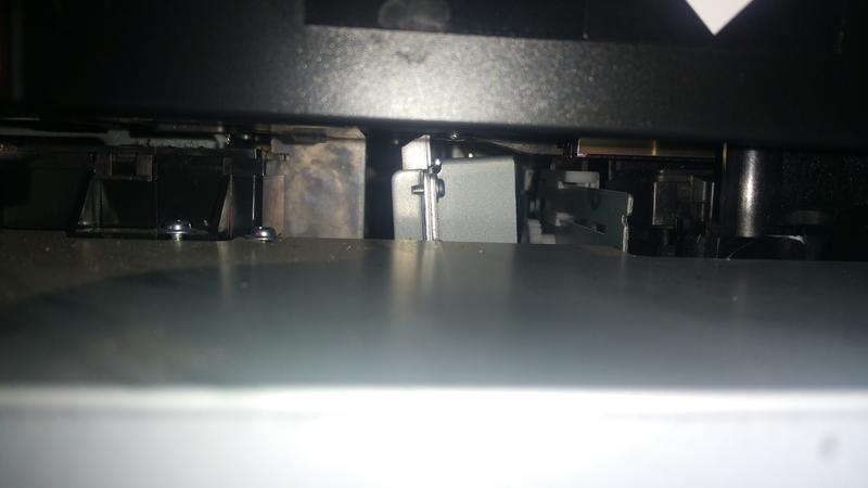

UPDATE: TEMP FIX before my printer took a Jacuzzi vacation in its own ink. fml
... see thing pointing up in the pic, that metal part shifted over a few degrees (its supposed to be at 90). to fix push it to the right and presto! TEMP FIX.

That's the head lock mechanism and it malfunctions fairly regularly on these machines. This would be the thing that got in the way of your print head so the motor over loaded. So it's more of a fix fix if you ask me! The only other thing you could do is replace it so the metal starts out a little stronger but it may not be worth the time.

thank you a lot i really appreciate the help, is there something i can do now to prevent that from happening again?

It's more of a design flaw. The head rests on the lock when it's not being used. Over time the metal just gives in and bends to the side the head is pushing towards. The higher end versions of that machine have a much more robust lock system and I am willing to be the next models from Mutoh will all have the new lock type.
