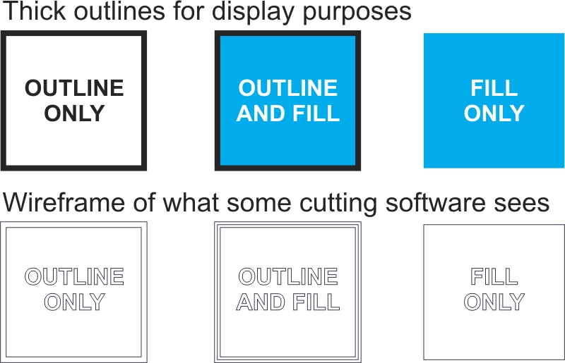

The "X" at the top of your color pallet is no color. Left click = fill and right click = outline. So if you left click a color to fill the object and then right click on the "X" the outline disappears.
Jester1167
Here is a graphic example.

Ok........... Just tried to cut my logo......... I have come to the conclusion that Jester is a genious!!!! I cut the logo with outline, no fill, and it cut once really fast. I also cut one with fill, no outlines, it cut once but a lot slower! Either way it only cut once so it doesn't screw up my graphics now!!! Have been fighting this battle for 6 years, you don't know how much I appreciate it! You all are the bomb!!!
