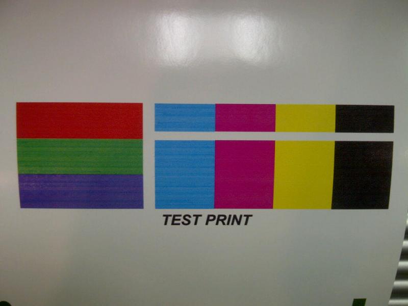

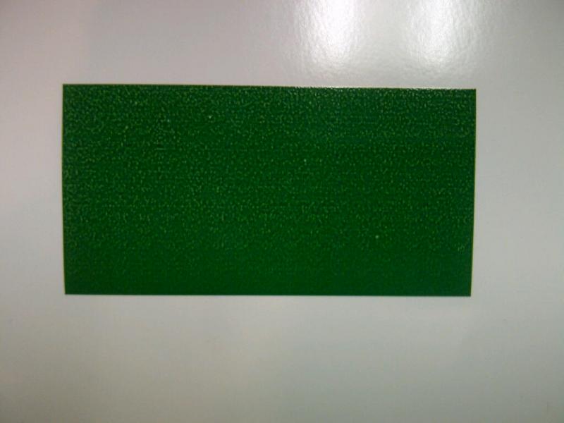

We're getting a perfect nozzle test pattern, but have banding like crazy!
Here's what we've done
- completely removed maintenance station. Cleaned all parts and looks like brand new now. Capping station is only 6 - 8 months old
- swabbed t-fence
- swabbed PF Encoder
- am able to pull ink thru both drain tubes under capping station.
Could it be a head alignment issue? What steps, in order, should I do first?
Here's a look @ our last test print.

the green swatch looks like a heat issue...not enough heat IMO but try to lower/raise it to test...also looks like cyan has a bit of banding...maybe show a nozzle test?
