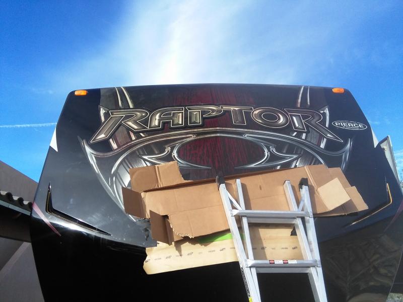

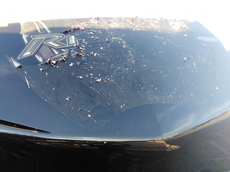

I have removed this 2 year old rv decal at the customers request. It took 7 painful hours. The glue was dry as hell but lively. I couldn't get it to " snot"
( in first picture with ladder) I used all my glue removal methods Rapid tac, vin.off, razor tool min spirits, heat gun. The glue was on paint, and not responsive, but finally came off, many hours later. In this picture the customer set up this lame ladder deal, just to show me.
I have installed a few similar decals before. The new one that the customer is providing is fresh from the factory and 3 parts going across horizontal. The front cap of the trailer has a crease up and down the middle, and the rest of surface is curved.
The main decal( contour cut) is taped while the other 2 decals aren't taped.
Whats the best way to install these without creasing the thing? I wonder if its OK to wet it up with a spray. Theres no info on this provided. The last time I put one of these on, I did crease it somewhat, I'd like to avoid that this time around. Thanks IMG_20161212_151540.jpg IMG_20161212_163648.jpg
What kind of material is it, does it have air egress? I would imagine the center piece has the transfer tape to try and keep it from stretching to much when applying, then the other two don't so they can conform to the shape of the front a little easier. Try to let it lay where it wants to, and work from the middle out, pushing towards the curve. I probably wouldn't apply wet because when you get to the outside areas that will need a little pulling, you will want it to stick.

Here is a big tip on removal. Use the MBX Vinyl Zapper. It would strip the decal and all glue in 3 - 4 minutes. I've used it dozens of times with perfect results every time.
Kottwitz-Graphics
As far as removal, try a wallpaper steamer. It heats up the adhesive and softens the vinyl, making removal that much easier.
As far as application, I'd think rapid tac and a heat gun would be the way to go... you can use application fluid on most vinyl, except reflective.

Except on aluminum panels (ambulance, fire trucks). It will burn the paint, and turn it yellow...
I don't know the type of vinyl, it doesn't say. I'm just going to have to wing it.
I'll spray it a little to get some slide.
