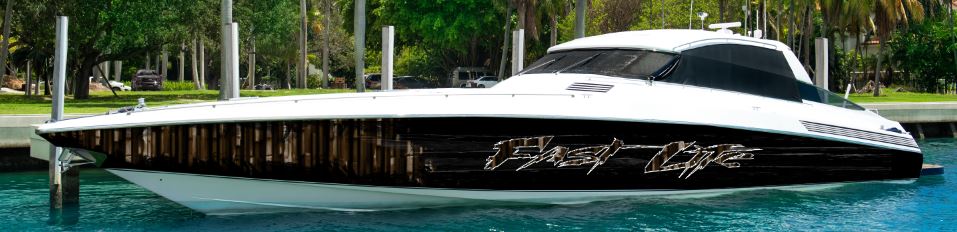

I am wrap designer my specialty is boats I normally keep the front end solid and the back edges. feel free to reach out to me with any wrap questions

This is a sample of one design maybe this will help you.
