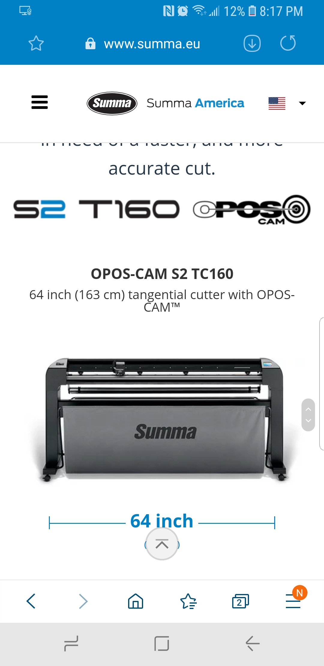

Here is my suggestion as a non flatbed plotter there is really nothing even comparable w quality, accurqcy and speed is great
Below is screenshot what i would suggest though
