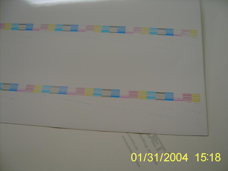

Well here's my test print or nozzle check after installing the print heads pulling ink and alot of frustration. Any ideas? i even set the inks to max ran test prints and still tiny lines etc..

Ive never used one of those, but is there an option to do an ink fill. Looks like theres some air in your lines, and ink needs to get to the pumps/heads.

that's what im going to do today. I believe i can do a fill just got to go thru the manual.

Press buttons as follows:
"menu" 5 times (= menu utility)
"enter"
"menu up" 4 times (=Fill)
"resolution" (=yes)
"enter"
