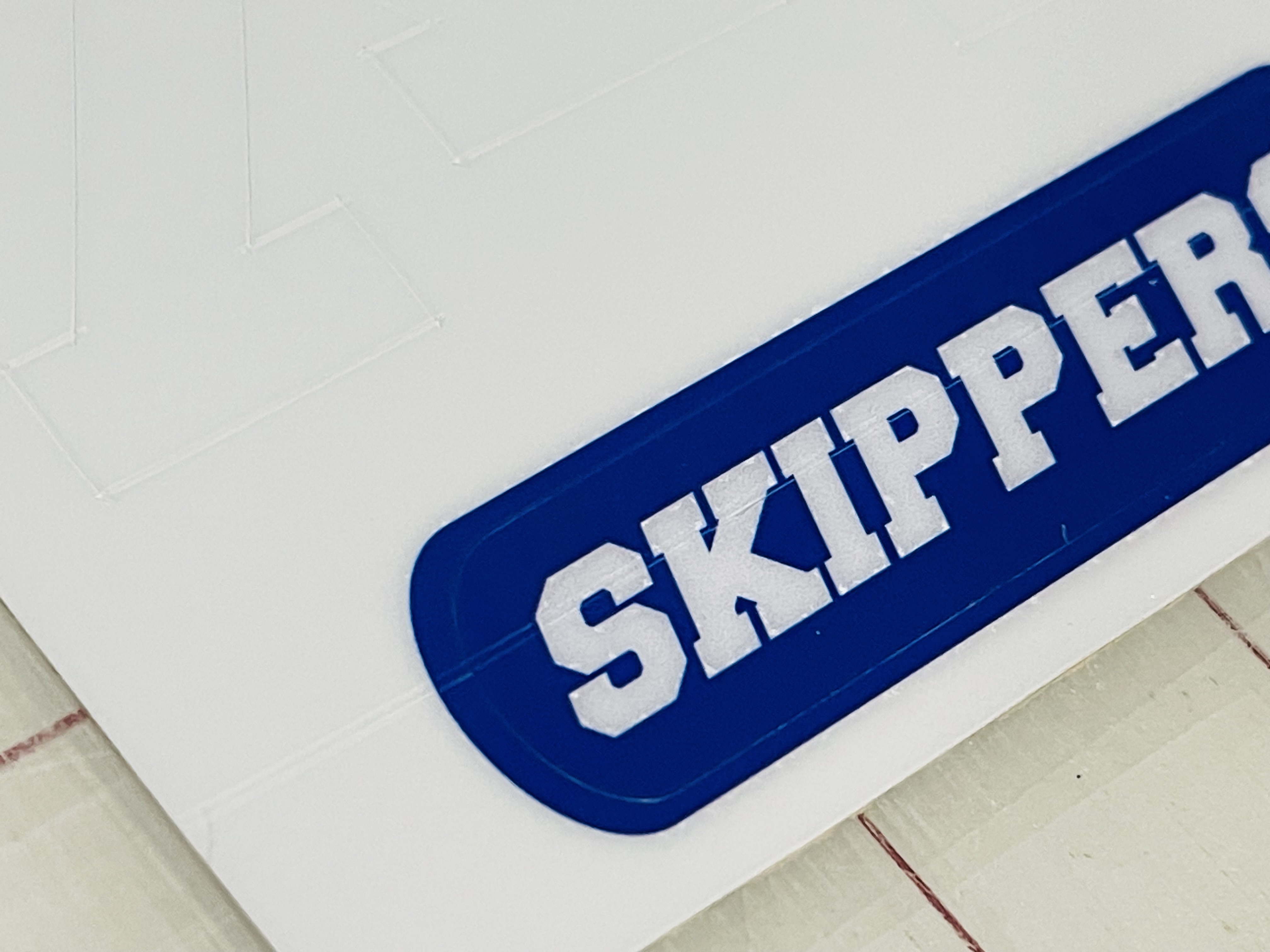

Got my brand new S3 running (finally and thanks to many of you for helping!). I am getting some drag cuts across some of my prints - anyone know how to prevent this? They are not deep - but the knife is dragging and making small marks in my print. Using tangential cut/blade. (See pic - marks across the letters are visible).
It’s like the knife isn’t lifting high enough when carriage is moving to different spots.
In addition to checking the blade exposition as you were advised, try using the black NOSE PIECE, normally it should be used with the 60° (and 45°) knife but it can also be used with the 36°. It allows you to keep the blade higher when moving

Your blade is exposed too much or the material is buckling while moving back and forth.
I will check the blade - thank you!
As far as material buckling - it seems the vacuum is much less on this Summa compared to my roland printer. I use a lot of smaller sheets (30" width by let's say 26" in length) and it's thicker material/lam - so would making the material longer in length add more weight and thus prevent the buckling more?

I will check for the black nose piece - the default one is silver, correct? I will have to look - thanks!

Using the black nose piece should help, and set cutter to the slowest speed you can tolerate. If you are cutting thicker lams on the regular I would highly suggest adding another pinch roller, Summa calls it a "media select kit" for some reason. It will pay for itself within a year.
