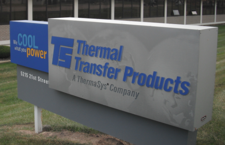

how about just printing a greyscale on clear, laminating the aluminum with it and applying your red headline afterwards with cut vinyl?
we did this with a recent project, where the client wanted a brushed aluminum finish with a watermark of the global continents:
beyond me why i don't have pix of this sign at night, as the letters are push-thru plexi with trans.blue vinyl on the faces.... F'n sweeeeet when lit up!
