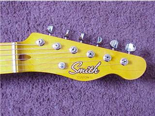

Interesting. I've got a really good friend who makes award winning amps and guitars. He actually uses the water slide sheets they sell for Testors models, prints his headstock logo on them (which has an outline of his logo) on a Deskjet printer, backfills them with a paint pen then applies them. Couple of coats of clear over the top, polish them out and they'll be there forever.
http://www.smithcustomamps.com/html/guitars.html
