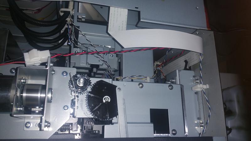

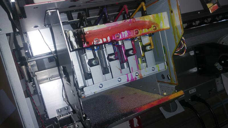

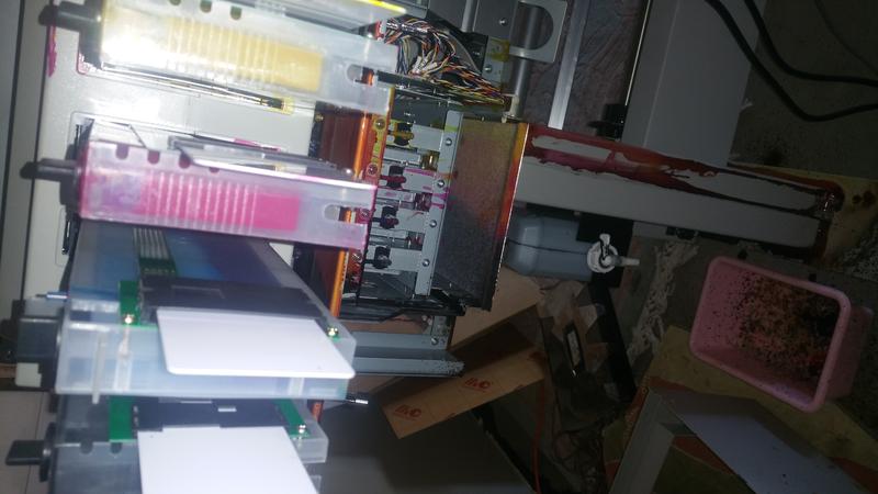

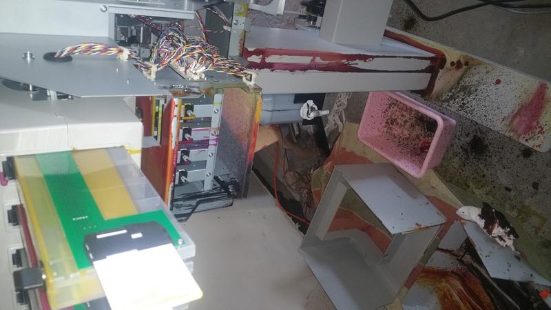

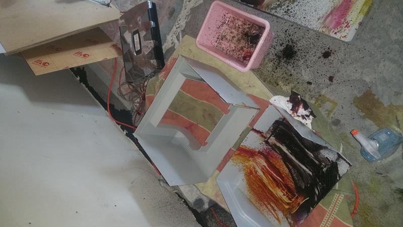

Literally look over to the corner and see a puddle of ink. Need help please what causes this to happen and how can I fix this? It's a mutoh 1624
I assume its 3rd party ink, maybe quckly drying, destroying, o rings,.....
when did you last time change anything, dampers, pump, o rings,....
im gonna every 1,5-2y, make these changes just in case, of course if printhead doesnt die before
hope you get sorted out fast and min investment...
0igo
It was the 3rd party ink cartridges. For Some reason 3 got a split on the top part causing ink to over flow. Luckily I seen in it time before it hit the wires on the right side.
