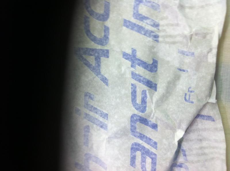

I have a customer who owns a fleet of sprinter vehicles and caravans and offers wheelchair taxi services. All his vehicles are generally new, but he also hires drivers with their own vehicles which are usually &*%$ box old vans. Today I get a 2001 Sienna and as I am cleaning the doors I see that the paint looks dull and not like car paint at all.
I first start with doing a vehicle number and I apply it. remove the premask and I see silver paint on the mask.
I explain to the driver who is waiting, and a very nice man and a new Canadian as well that someone has repainted the doors using a spray bomb (probably him) and that I can't guarantee the lettering. He tells me he needs it on there or they won't allow him on the road. I understand his dilemma and proceed to put the company name on the doors. I also decided to wet the premask before removing to reduce the adhesion. There's no way this van can even go through a car wash. I did the other door and as I removed the premask the paint and the letters almost all came off. I had an extra set so I first put high tack pre mask down and then removed this layer of silver paint. I then proceed to put the lettering down and when I went to remove the mask, low and behold a second layer of paint was coming off revealing a light blue colour beneath.
What a butcher job, but he needs it to feed his family and I told him if they start falling off to come back and I would give him a very good deal for some magnetics to get him through the next month or so (says he has a new vehicle coming)
check out the pic of the second side when I removed wet premask...just WOW!!! had to use magnets on this job and no masking tape as it took the paint off as well

Holy crap, thats cute! :D
Btw, i love it more, when stuff like that happens, and you are telling the customer that the decal might fail... they say its fine and they DO UNDERSTAND. And guess what, some of them are coming back and complaining that decals fall off. Because of that, if stuff like that appears, we ask customer to sign the invoice, where the problem is described.
