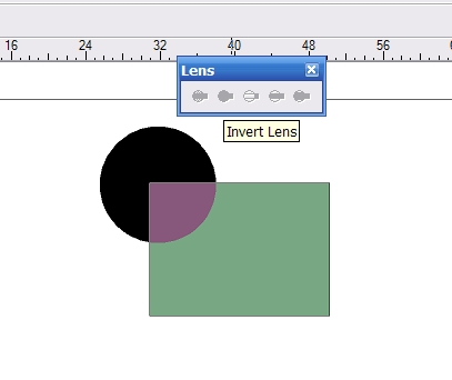

Say you have a typical square image and you want to mask out a circle from it. When you would drag, or size the circle over top of the image it would become transparent and kinda as a negative (of color) so you can easily mask the image just how you want.

Ok, this is my last try! Is this picture what you're looking to do? That is called invert lens in the effects menu.

I think we have a winner! Here is a nother pic of a circle with invert lens applied to it over a bitmap. Now I can get back to work! :smile:

The inverted lens is what I am trying to explain. However you don't need to go effect - lens and manually do it.
This automatically happens when you select your desired object and as soon as you deselect it the object returns to its original solid.
Right now I currently mask the piece out and use the select within to move the images as need. However it is a few more steps than necessary.
In this picture this is what will happen to either object when one is selected and a portion is overlapped.
Example.
Right now if I were to select the green square and drag over the circle the green square would remain a solid.
There is a setting that can be change by hitting a series of shortcut keys or something that will allow the object that you have selected to become this "inverted lens" when it is over top another object.

Try toggling between on & off the "Show Preview" option under the "View" menu. That should do the trick.
