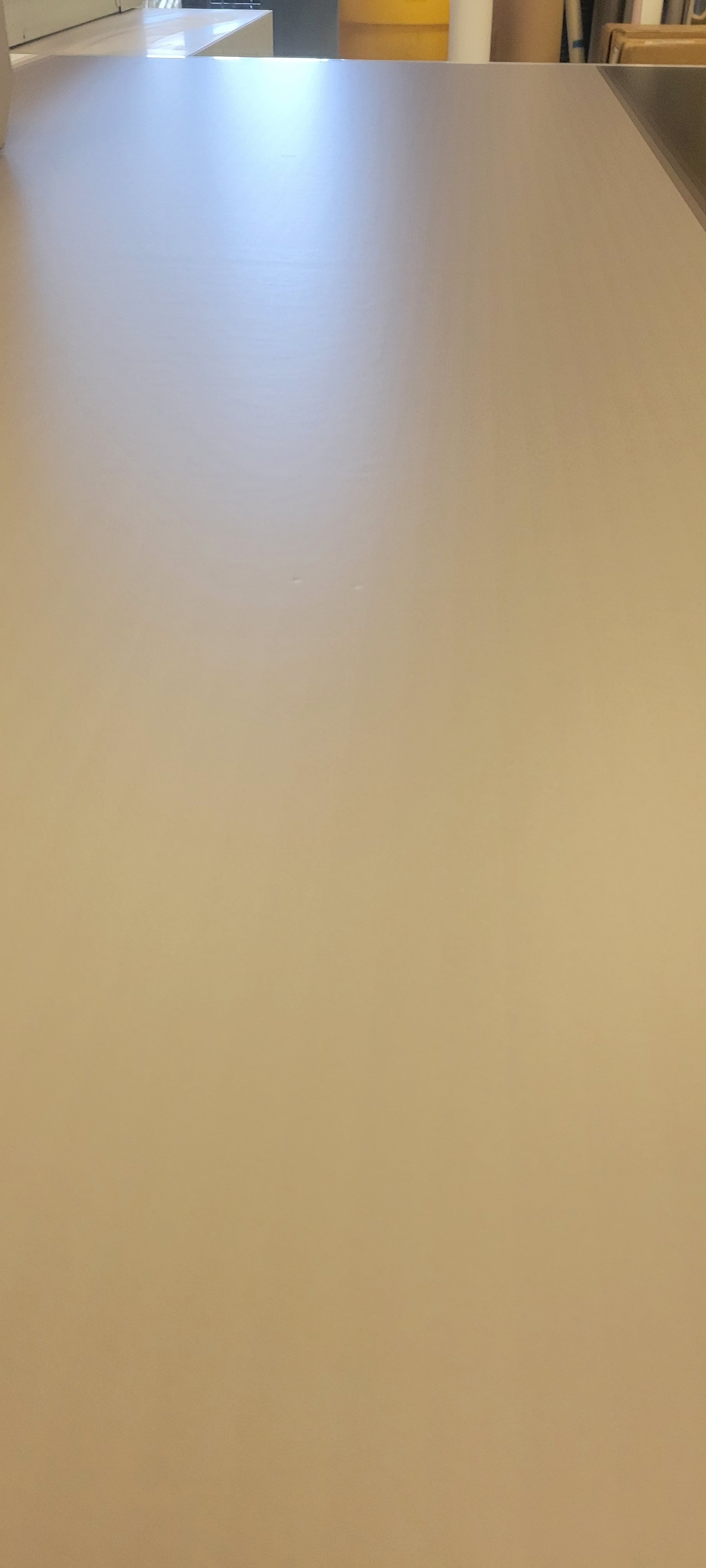

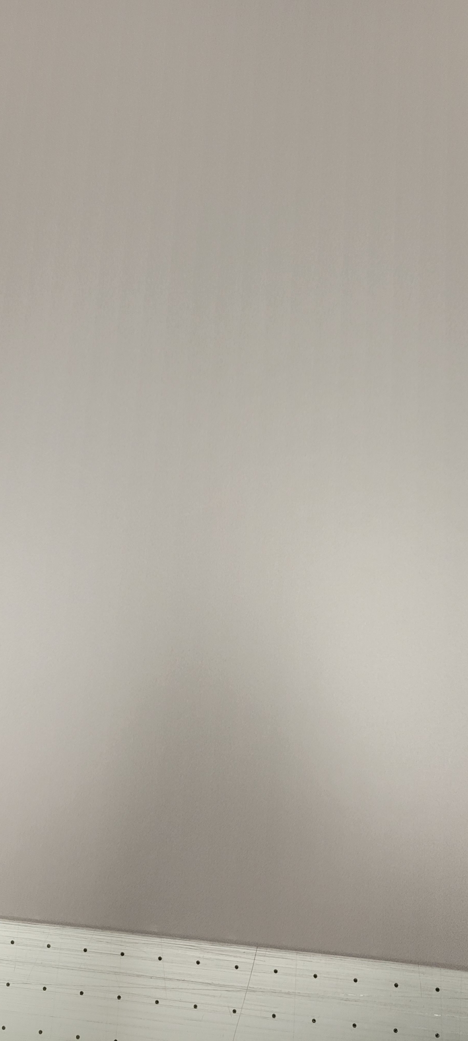

Every time I print solid colors on Ultraboard I get banding. Has anyone else had this problem? It's hard to see in the pictures, but very noticeable in person.

We get that on our Arizona, have never found a way around it.
Have you tried adjusting lamps to see if it makes and difference?
AlsEU
Check also if the percentage of solid colour matters - i.e. try 100% and 70% of the same pure colour (use only pure CMYK solids, nothing else).
