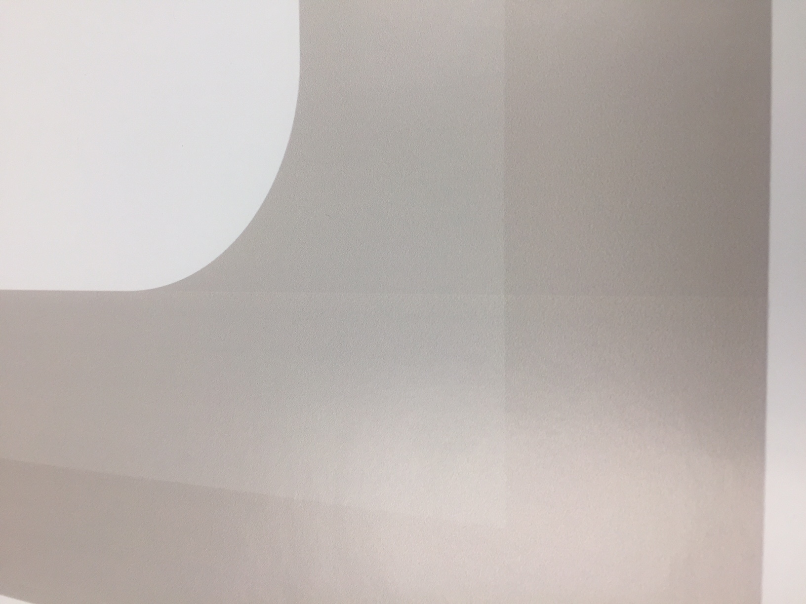

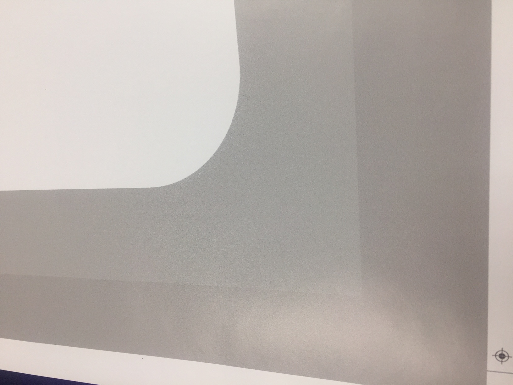

Here is a clear indication of the issue which still puzzle me why HP will not rectify this problem. I don't remember seeing this on the L25500 which had two lc/lm printheads.
This job came in today. Large sign that did not need CMYKcm and I wanted to print at 10pass. I also recognized that this issue would probably show up if using CMYKcm. Like most jobs of this nature I always use CMYK unless it is POP signage that needs less graininess. During printing I remembered this thread and wondered would it show up if I used CMYKcm with the preset set for 200 inter-pass delay. The gray combination border was 4' across and you can clearly see the results. Output profile black generation was set to start at 30% so lc/lm was being used heavily to create the light/medium gray.

Yeah, that's not a printer issue. That's a "design software / rip" issue.
Not likely. It shows up in CMYKcm mode but not in CMYK mode. I have seen this many times. Defiantly a flaw in the L300 printers be it ink starvation or some other problem.

dypinc
Interesting idea but that doesn't account for my samples I posted previously.
The same gray border with the same nozzles firing there is a difference when the 4' of gray was printing and when only 4" at the side was printing. This shows up both at the beginning and at the end of the print. And the lighter area is always where more ink is being laid down.
And, if the lc/lm printhead is not being used it doesn't show up.
So how would the Gutter option help in this situation since around 4" on both side are being printed firing the nozzles?
And remember in the Purple Green sample, some amount of the Purple has been firing all the time. Keeping the nozzles primed?
One possibility is that I have a bad lc/lm printhead but all tests do not show any issues and it shows around 2,000ml used.
