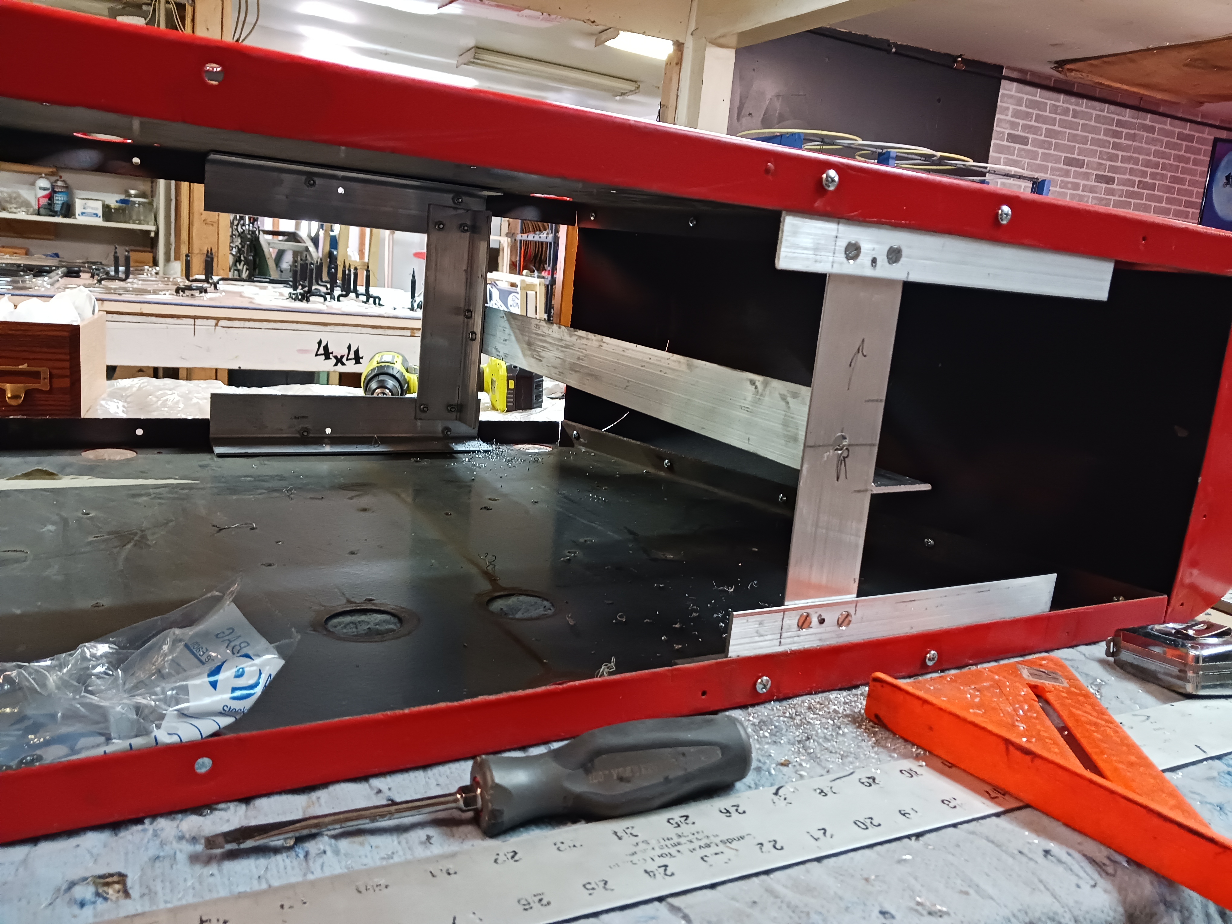

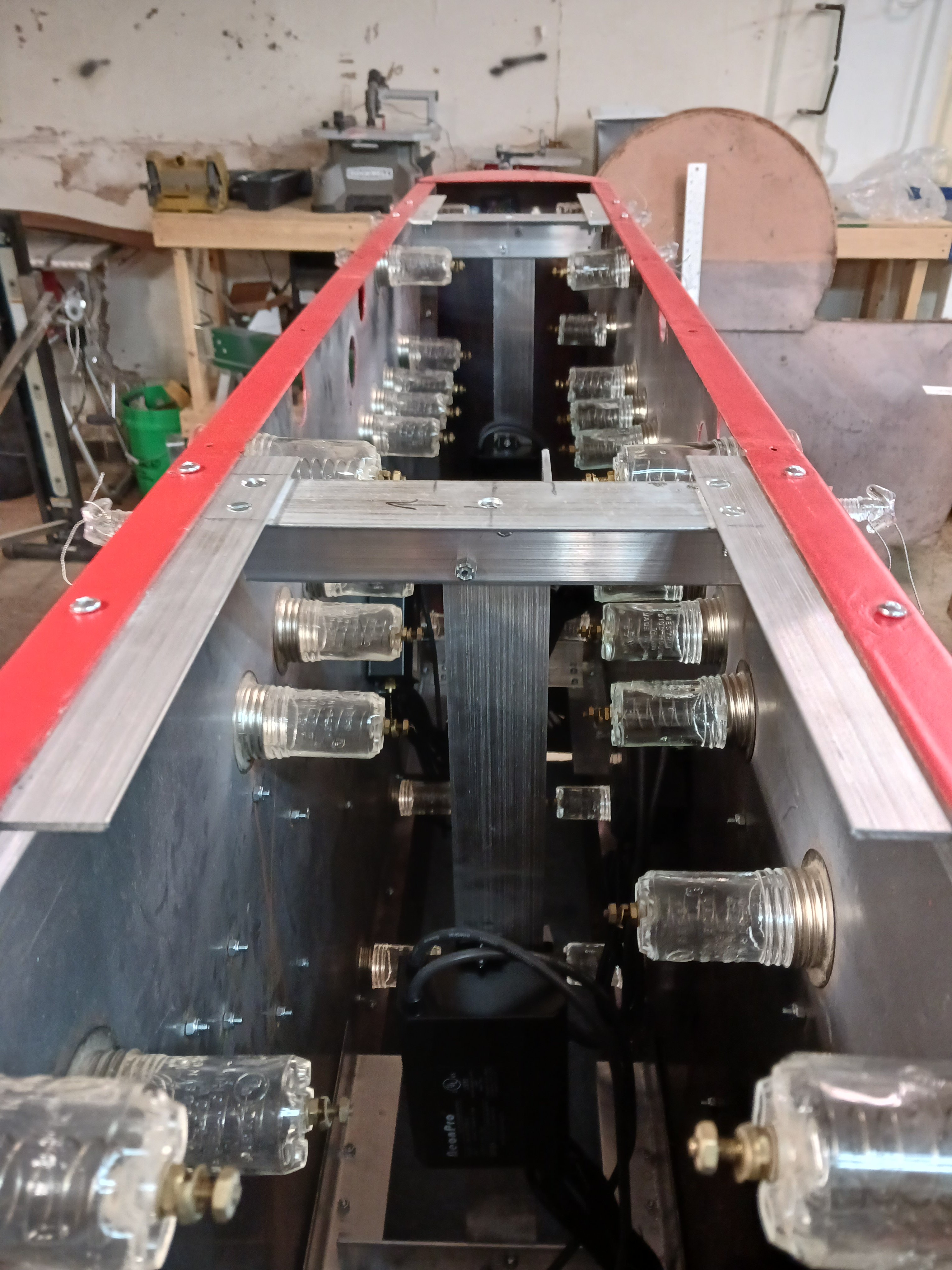

We had to reinforce the inside as rebuild the hangers for the eye bolts, we used aluminum angle.

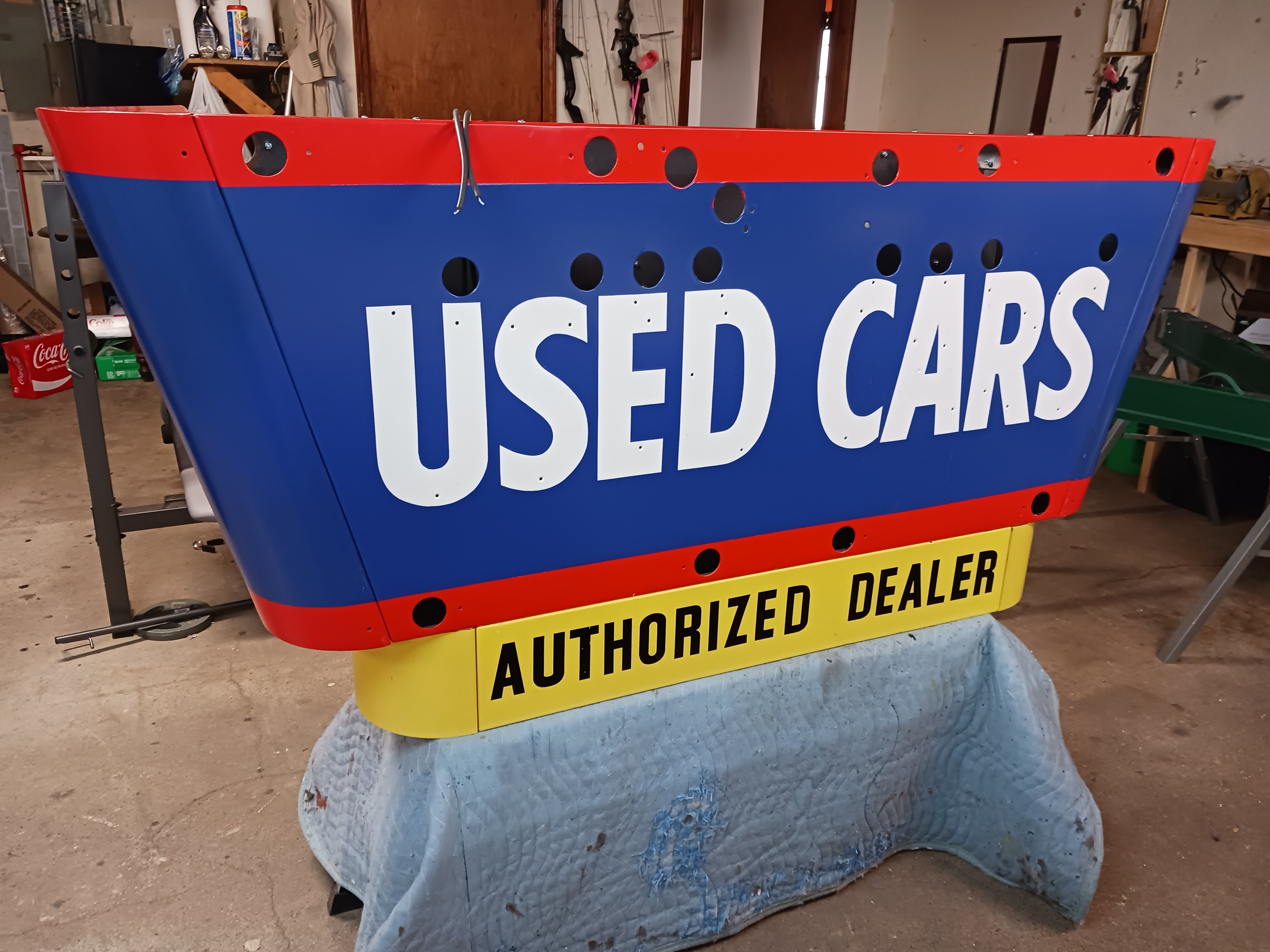

Next we attached the bottom faces and bull noses.

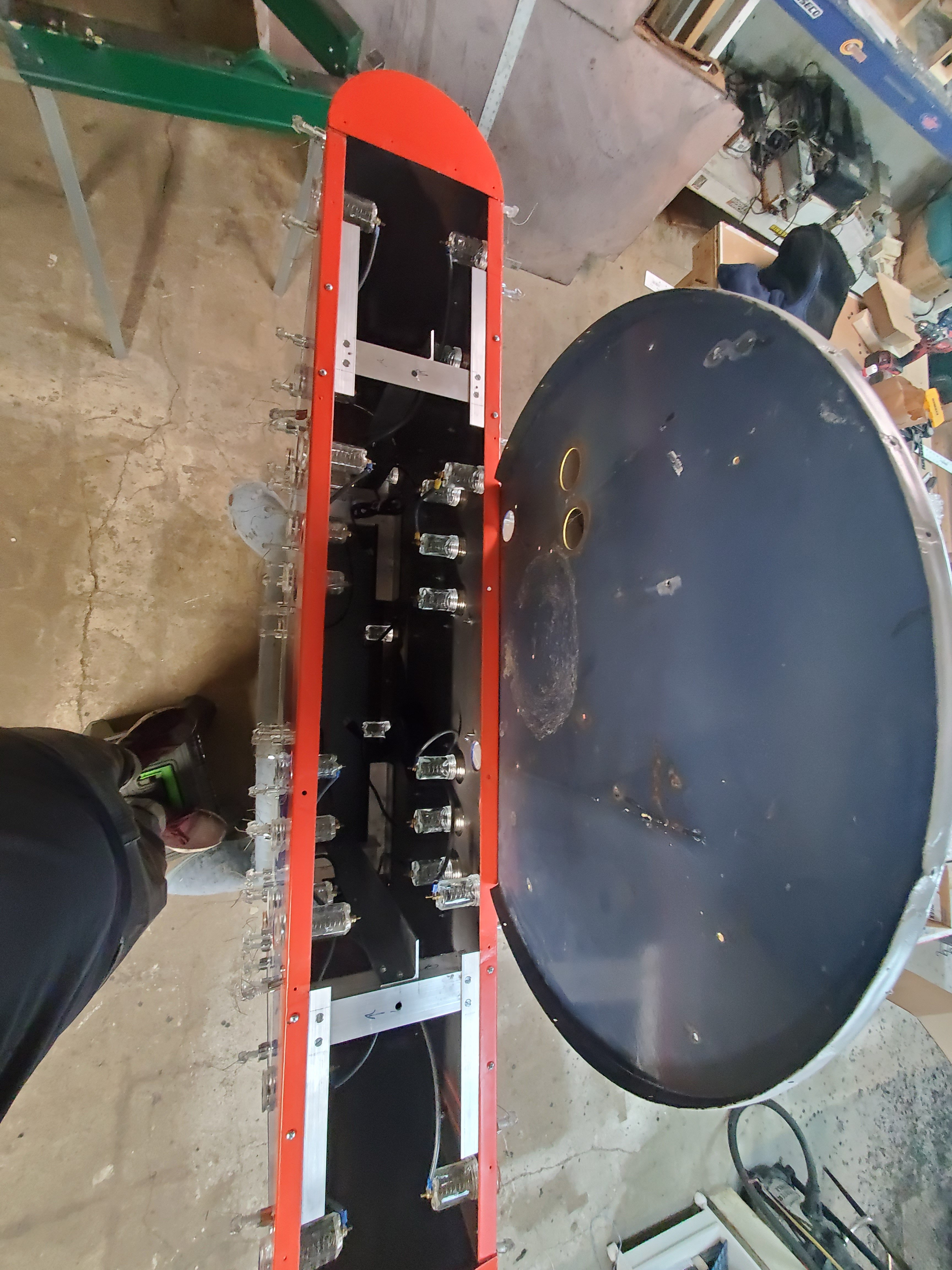

After putting all the housings for the bottom in, we mounted transformers and wired them up 4 transformers for the bottom/middle.

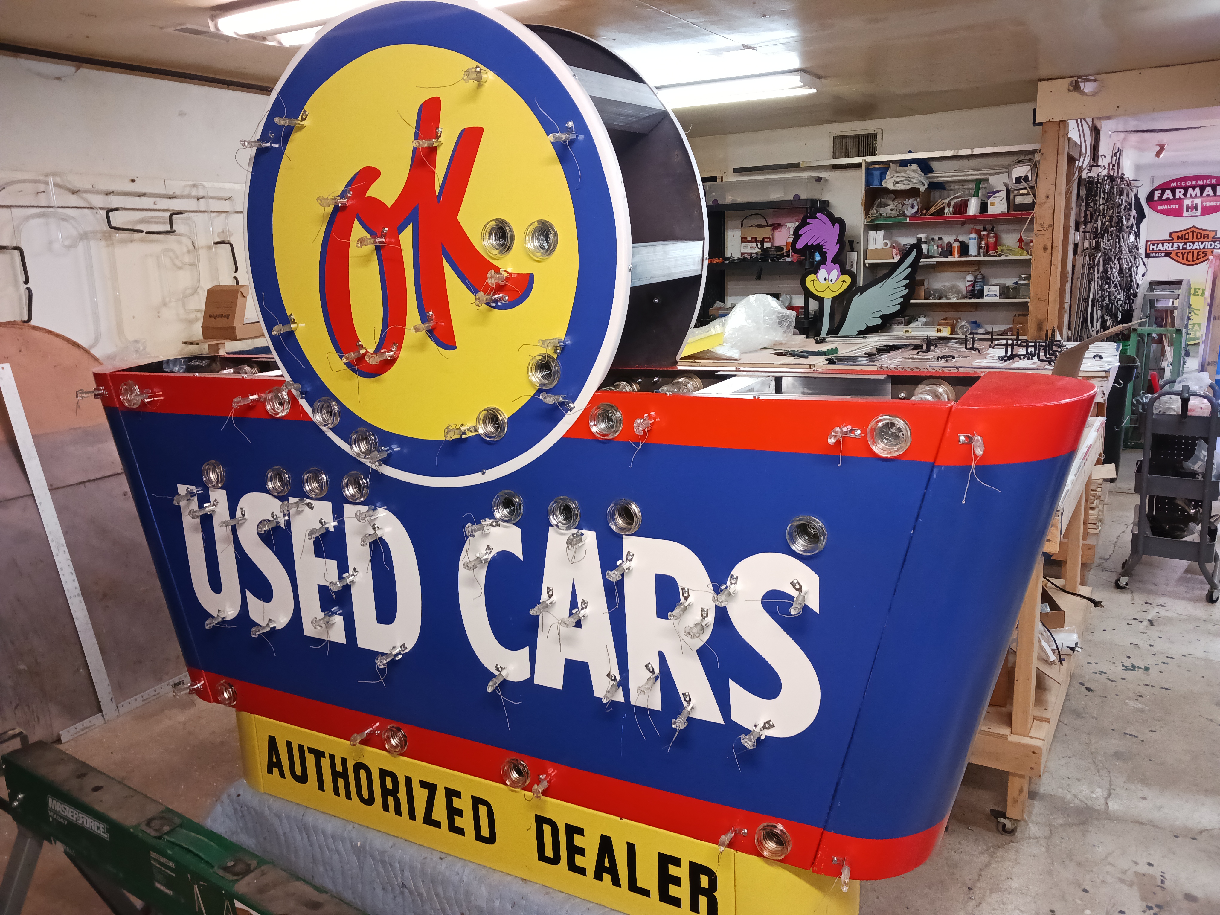

Next we attached the round faces at the top and reinforced them with more angle.
Next we cut sheet metal and paint them to cover the exposed parts.
