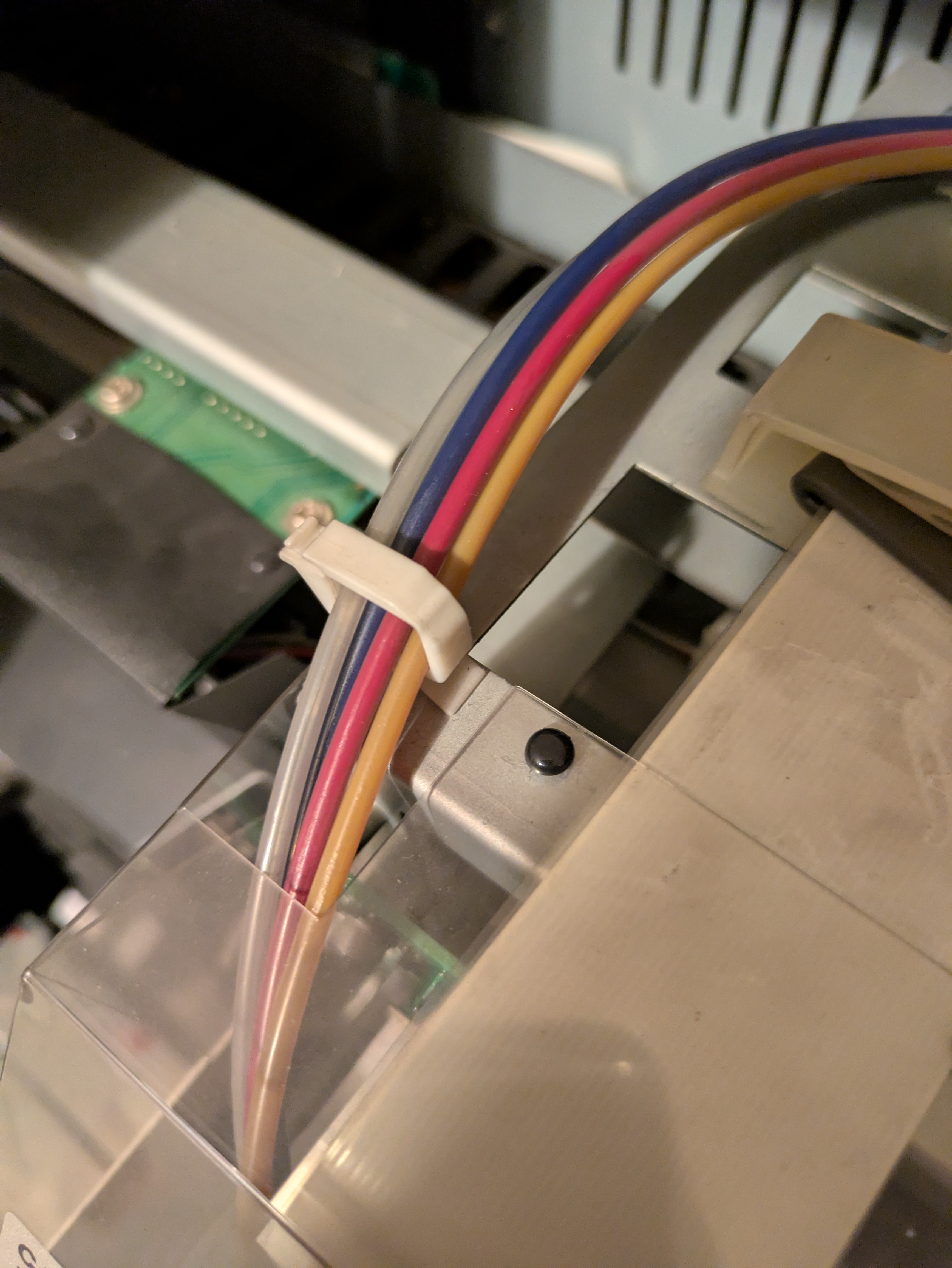

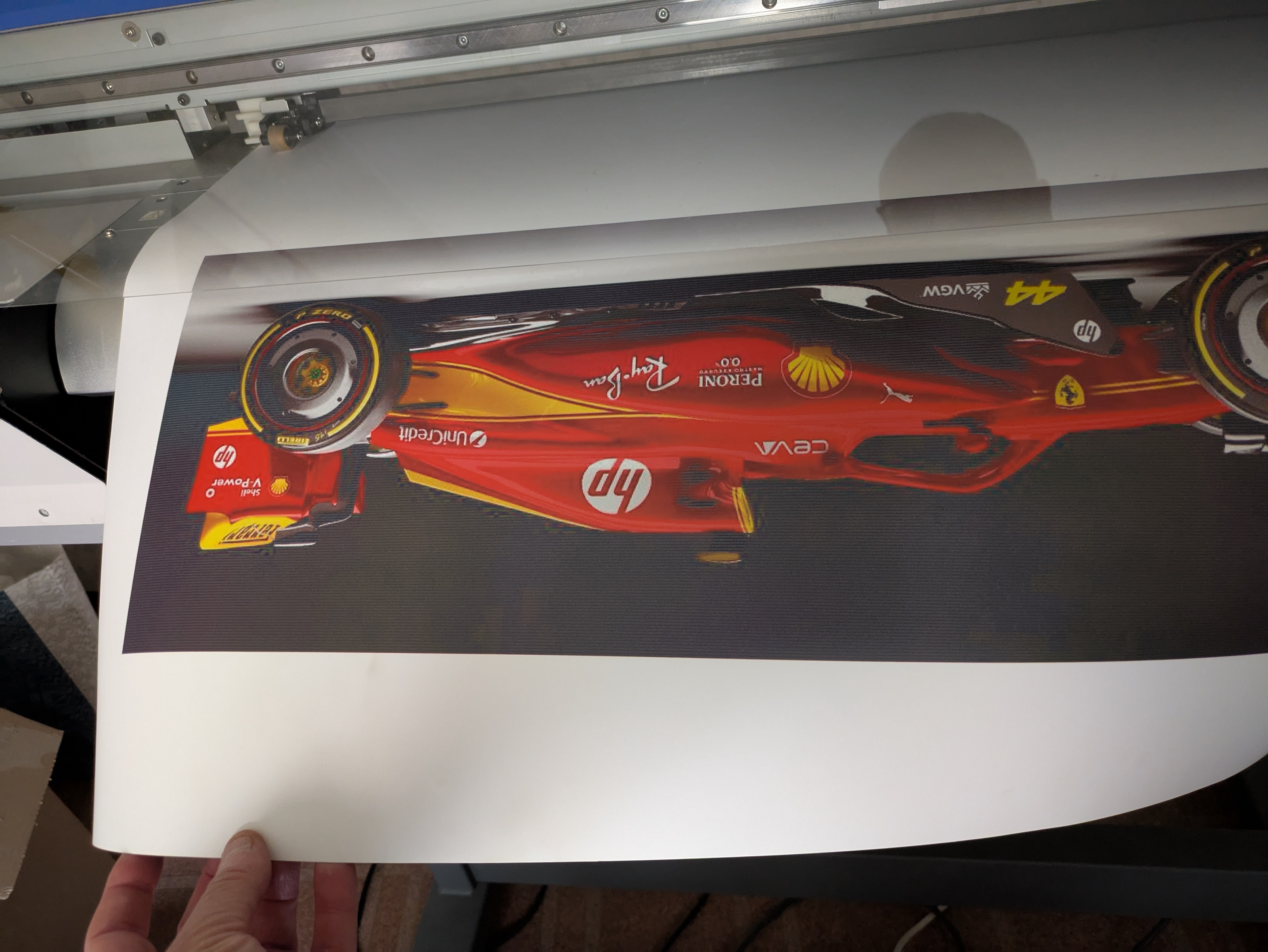

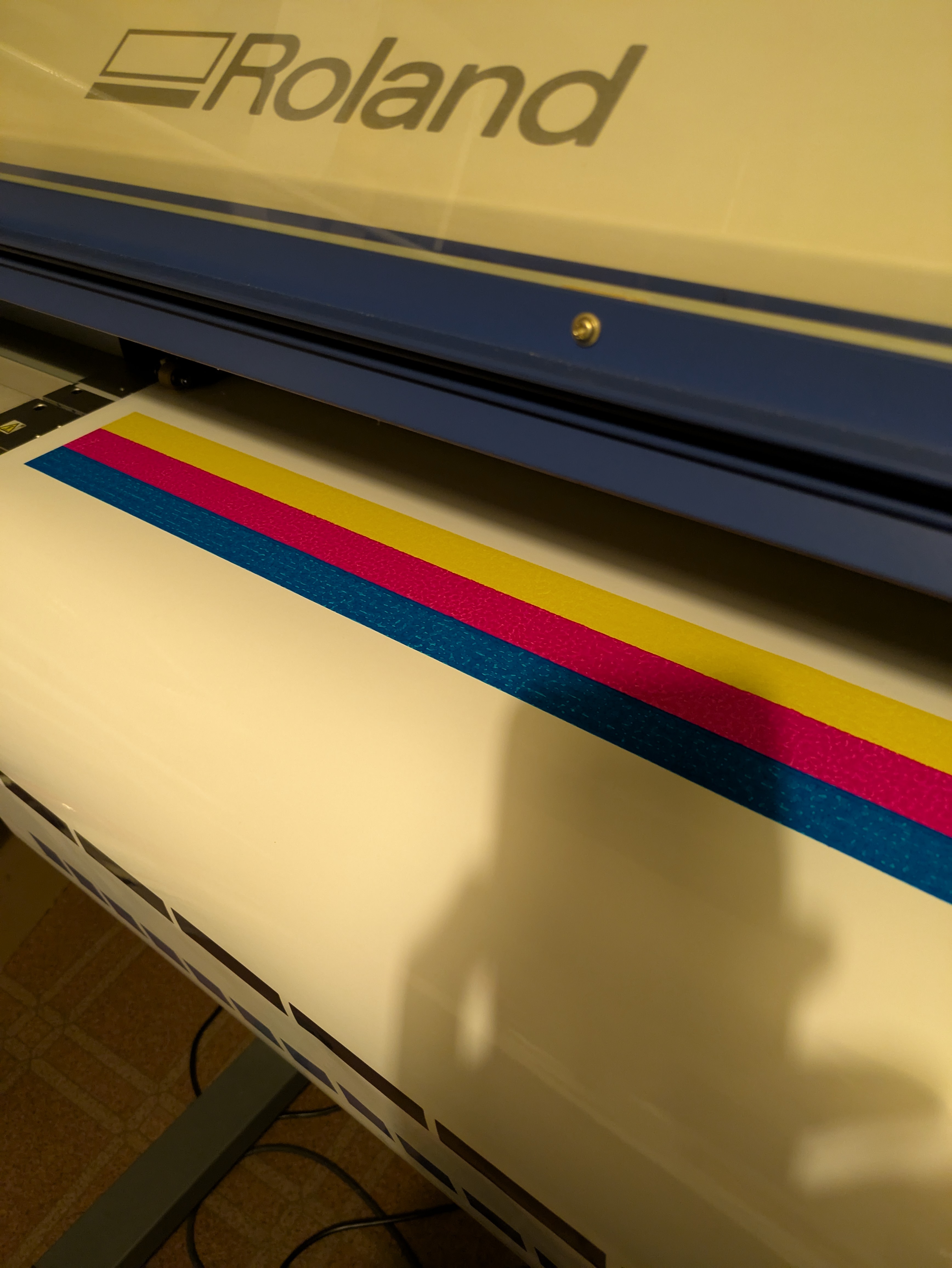

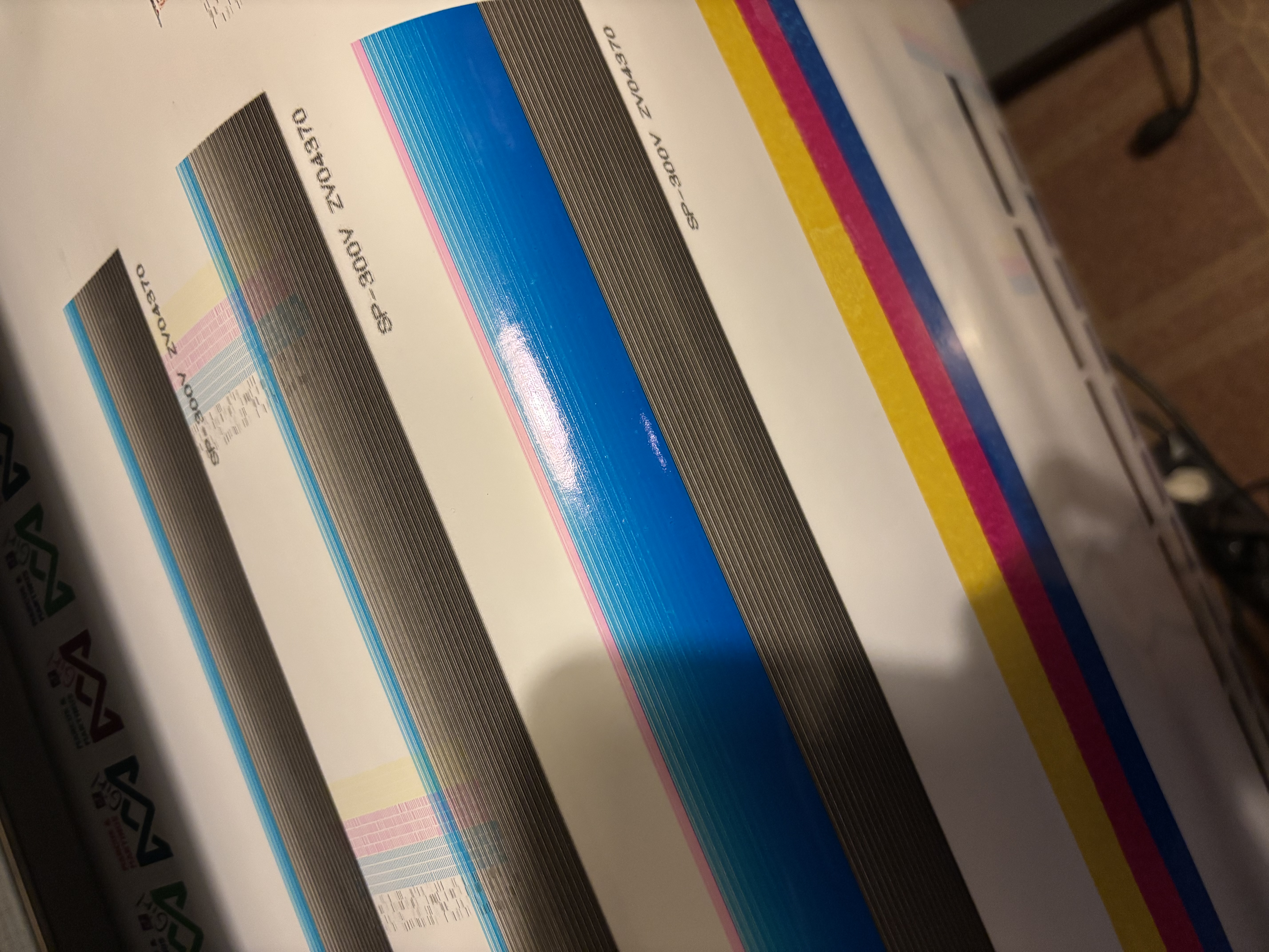

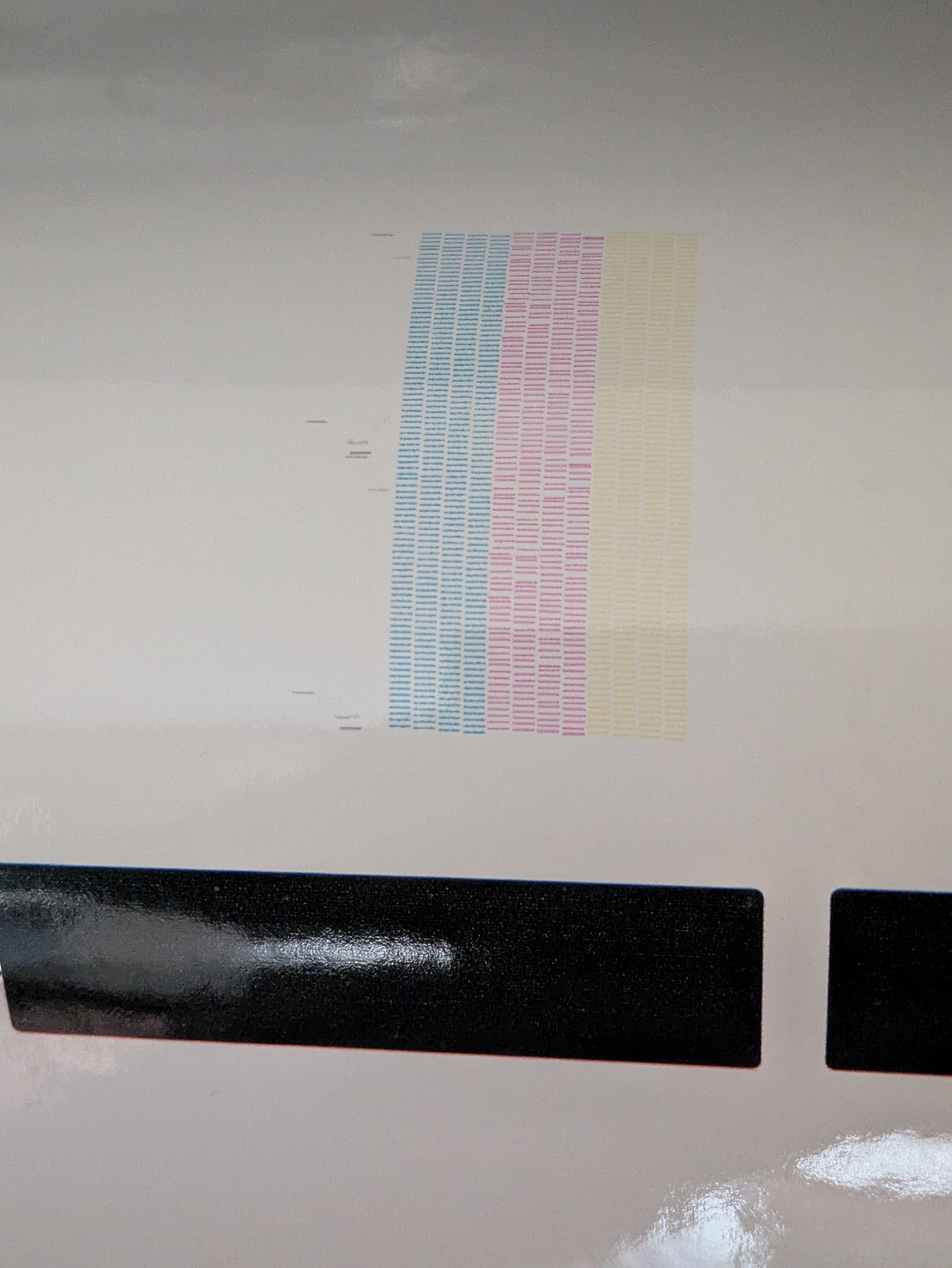

My old and reliable Roland has developed issues with black color. On the test print black is almost not visible, but if i print rectangle 100%K printer somehow manages to print decent good black. Please see attached photos. Other relevant facts:
my print volume is very low but i print something small al least every 4-5 days
black+cyan printhead was replaced by serviceman 2 years ago
after i discovered the problem few days ago i replaced captop and damper, checked all the pipes/lines manually cleaned everything, vipers too, 1 medium and 1 powerful cleaning cycle - no change
my black cartridge is very old from year 2019
Al in lines seems to be ok, no cross contamination.
Any ideas or advices on what to check further? Is it possible head/nozzles is/are bad after just 2 years of very light use?
